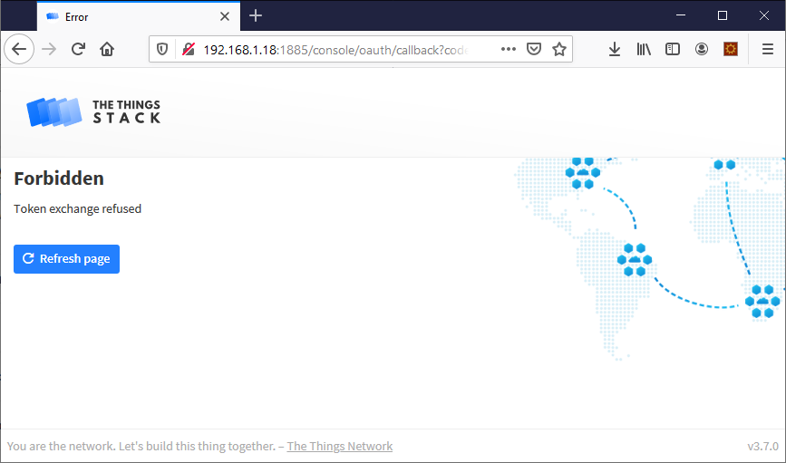

Token exchange refused
Hello,

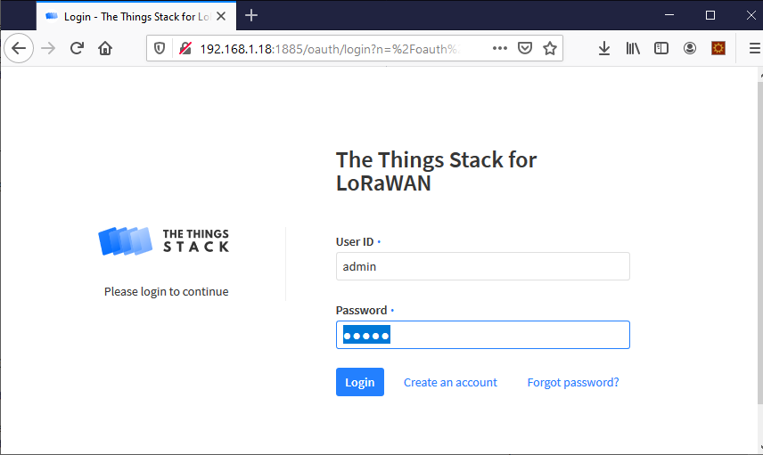

I have installed stack v3.7.0 on ubuntu server by using official procedure : https://thethingsstack.io/v3.7.0/guides/getting-started/
When I try to log in, I have this message :
On console at the same time :

stack_1      |   WARN error=unauthorized_client, internal_error=<nil> get_client=client check failed, client_id=console namespace=identityserver
stack_1      |   WARN OAuth error                              error=error:pkg/oauth:unauthorized_client (client is not authorized to request a token using this method) method=POST namespace=web remote_addr=127.0.0.1:45806 request_id=01E61X93V6PXCKD7MGQQ2D0YCW url=/oauth/token

Could anybody hely me please ?
I have run stack with config parameter
sudo docker-compose run --rm stack config
All URL are http://localhost:1885…, bu my server is not on local computer
How could I change these URLs ?

Hi @bq1,
I edited your posts to improve the formatting of the code blocks.
You can use environment variables or config files. See the documentation for details: https://thethingsstack.io/v3.7.0/reference/configuration/
This is likely also what’s causing the issue in the OAuth token exchange. The token exchange validates that the redirect URI parameter of the exchange request matches the redirect URI parameter of the authorize request. If your deployment is misconfigured that might not be the case.

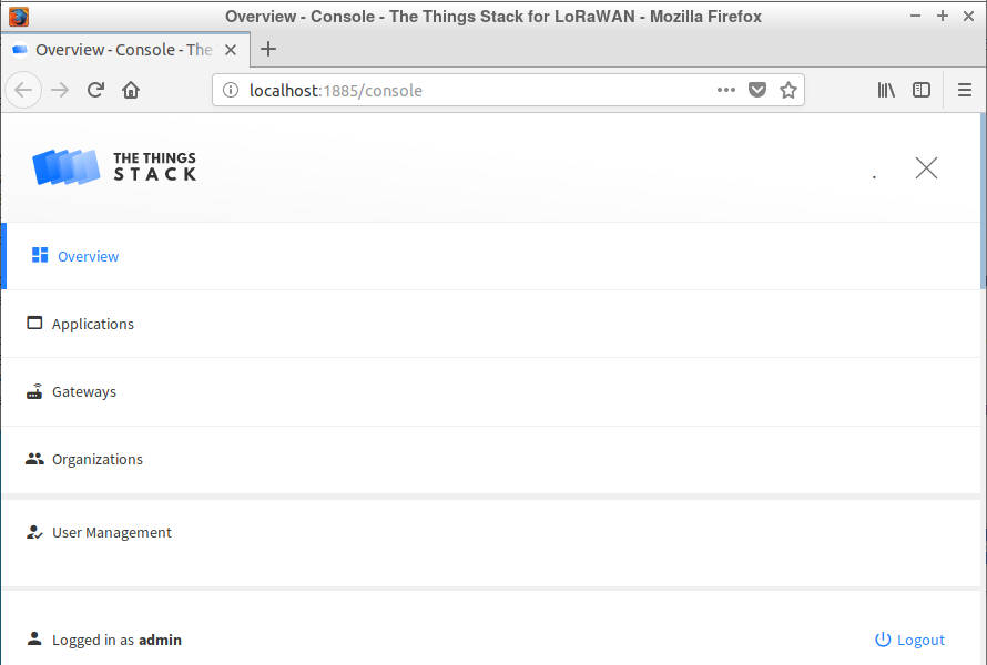

Thank you htdvisser,
Using server and browser on the same machine, it works with localhost !
But when I use a browser from another machine, it does not works !!!
I have tried to modify some TTN_LW_xxx constants in docker-compose.yml but it does not work !
I have this error “Token exchange refused”
  TTN_LW_CONSOLE_OAUTH_AUTHORIZE_URL: /oauth/authorize
  TTN_LW_CONSOLE_OAUTH_TOKEN_URL: /oauth/token
  TTN_LW_CONSOLE_UI_CANONICAL_URL: /console
Might be duplicate of https://github.com/TheThingsNetwork/lorawan-stack/issues/2353, please subscribe there
