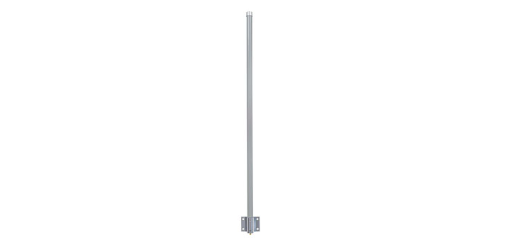

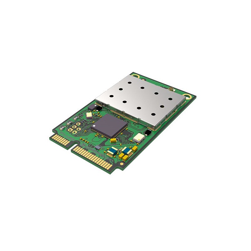

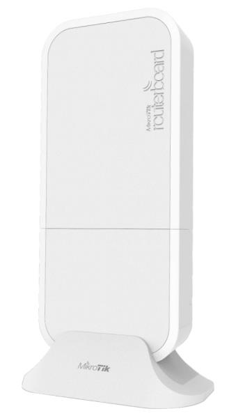

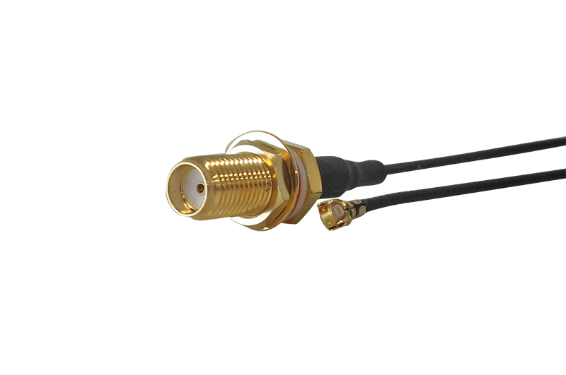

@richms no concrete news. The MikroTik gateways are in NZ and about $350 NZ for a complete gateway including external antenna.
GoWiFi are selling them. Give me a yell (john @ wheronet) and I’ll get you a quote at cost - we should also catch up. It’s been a while since ihug days!
External one kinda exceeds my effort threshold at the moment, plus I am in a terrible place for one of those adding anything to the network since I am virtually at sea level surrounded by big hills.
