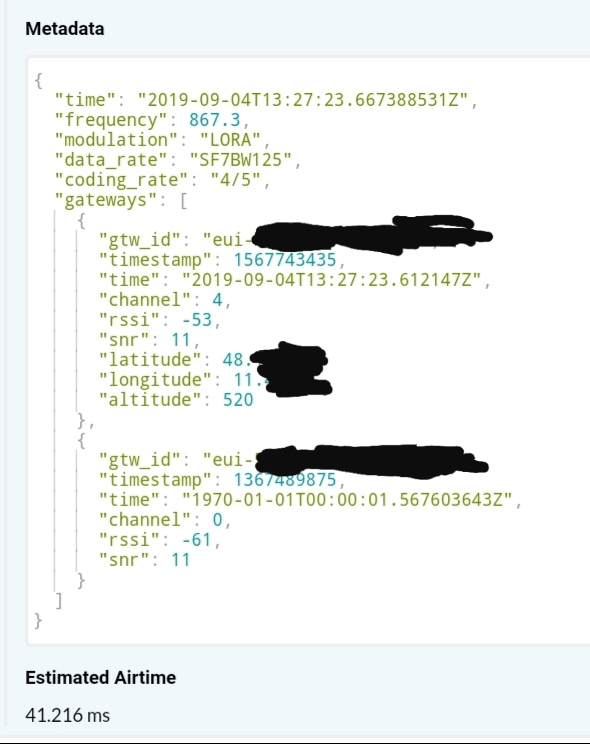

Hi, I have a TTIG now. Within several hours I found some serious errors and I can not find a workaround.
In application metadata I receive crippled information:
  1. channel is always 0.
  2. date/time is 1970-01-01…
  3. no longitude
  4. no latitude
  5. no altitude
    20190904_234114

Ok, let’s talk about debugging the problem. I think the data problem is the packet receiver of the ttn server and/or the packet forwarder of the TTIG.
The ttn server should inject the location which is set in the console/gateway/settings, but it doesn’t.
The time and channel issue maybe located in the TTIG.

Channel number and Timestamp seem to be missing metadata on the server side.

So in summary,
  1. The Things Indoor Gateway does not have a GPS, but you can set its location in the console. Then you’ll see it update within a couple of hours on https://www.thethingsnetwork.org/gateway-data/user/<your username> . The http://noc.thethingsnetwork.org:8085/api/v2/... API should be avoided.
  2. We will investigate the incorrect timestamp and the channel field.
  3. Please tell us more about this instability. Any logs will be really helpful.
