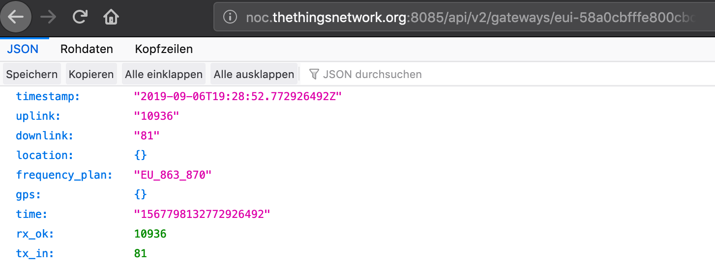

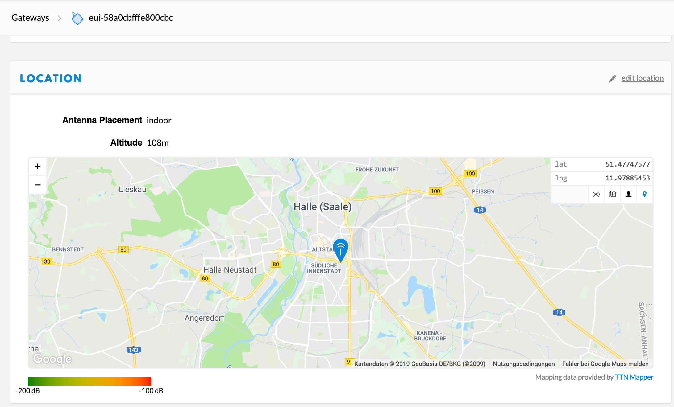

Showing my user data with the url above, the location is fine.
Unfortunately TTNMapper uses api data and there location is empty. Therefore I cannot contribute to the coverage map.
Ralf.
This behavior has been previously explained as expected. If the TTIG is not receiving any edge node transmissions, it resets its connection to the network.
Is there any solution for the TTIG gps coordinates problem ?
My TTIG has correct gps data in console and api
but not in noc and payload data
The coordinates have been set days ago
I need the data so that the gateway is displayed correctly in the ttnmapper.
