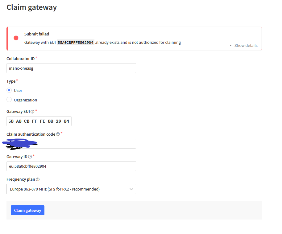

You don’t need anything but the WiFi password and EUI to claim (not add) it in V3 so if you have the hardware you are good to go. No need to know anything about the V2 account.
error
That means someone already added a gateway with this EUI in V3. As the gateway is still active in V2 (according to your message) it was not the result of a claim process.

This gateway is owned by the account inanc_oneasg, which is your own account. It seems to me that you have registered the gateway in V3 without claiming it. This is a common case despite our tool tips and warnings that we have built into the console. You can resolve this yourself by checking our docs:
https://www.thethingsindustries.com/docs/gateways/thethingsindoorgateway/#gateway-not-authorized-for-claiming
