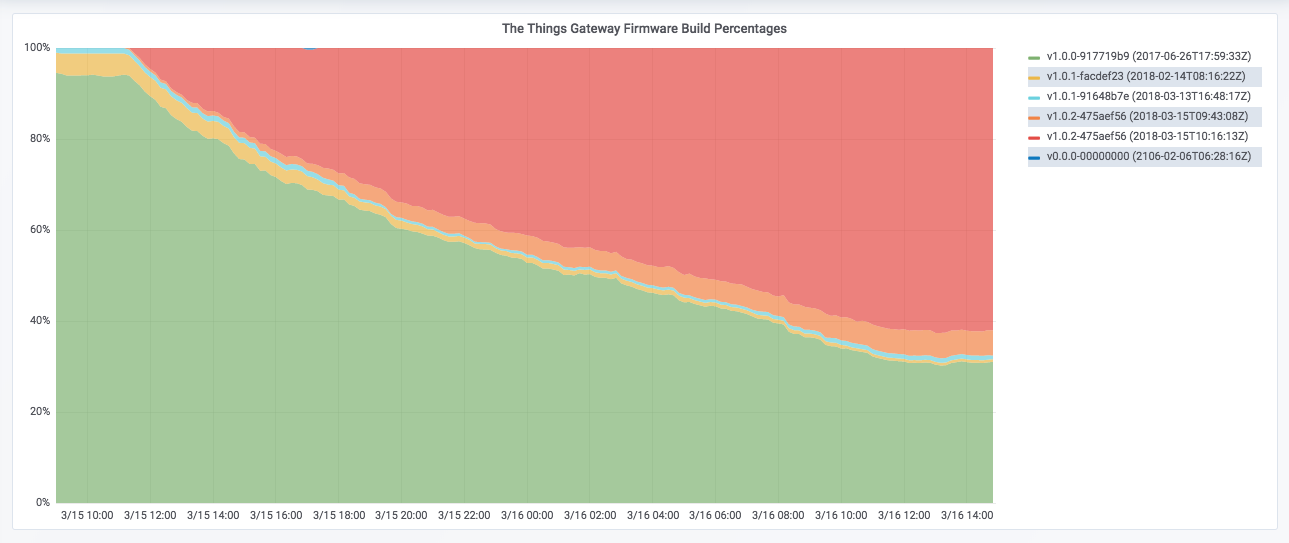

The Things Gateway firmware build percentage over the last 24 hours -
45
