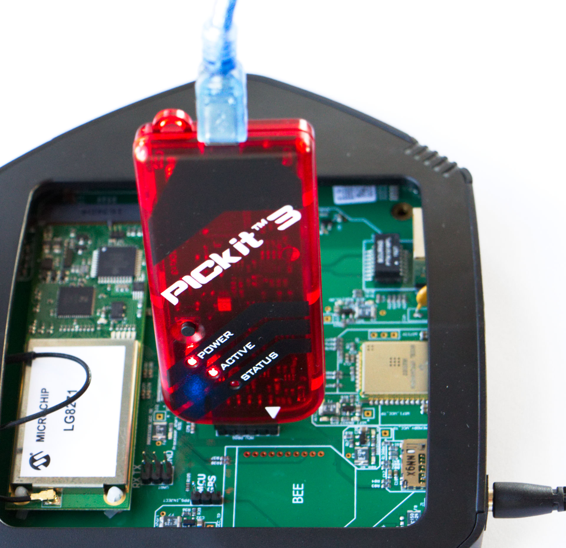

Today I flashed my first gateway with the latest bootloader using my fresh puchased PICkit4:
Version Info
Hardware: v1
Bootloader: r2-c463e87e (2018-02-23T14:42:40Z)
Firmware: v1.0.2-475aef56 (2018-03-15T10:16:13Z)
Only observation I have is that the programmer is complaining about an incomplete load:
2018-03-22 19:21:54 +0100 - Loading hex file. Please wait…
Loading code from C:\Users\drasv\Downloads\TTNGatewayFirmware\firmware-with-bootloader.hex…
Warning: C:\Users\drasv\Downloads\TTNGatewayFirmware\firmware-with-bootloader.hex contains code that is located at addresses that do not exist on the PIC32MZ2048EFM144.
Code incompletely loaded.
2018-03-22 19:21:55 +0100 - Hex file loaded successfully.
Not Nice and not good for your self confidence.

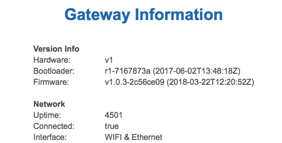

(Pfiadi) #112
Update using an SD Card went smooth:
Version Info
Hardware: v1
Bootloader: r1-7167873a (2017-06-02T13:48:18Z)
Firmware: v1.0.3-2c56ce09 (2018-03-22T12:20:52Z)
OTAA joins used too take ages with the old firmware (v1.01, same nodes). The gateway is up for >15 minutes and receives/transmits data.

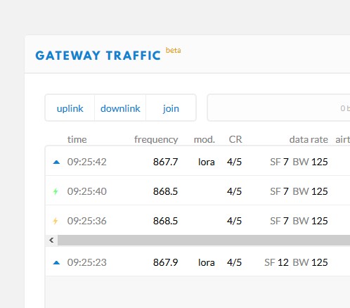

Observation: the TTN Gateway with the beta channel release “Firmware: v1.0.3-2c56ce09 (2018-03-22T12:20:52Z)” is not forwarding any packets at the moment.
Console is telling “connected” and last seen updates at regular intervals but nothing in the traffic window. also the received messages counter is not incrementing.
When checking the application of a node in the same room I see that no traffic is passing trough the TTN gateway.
#125
I can’t confirm this… here it’s 100% @ the moment
noproblemo
#126
Gateway here with version 1.03 is also not responding. Last seen 20 minutes ago.

Today i received a new PicKit4 programmer from Farnell.
First i accidentally used a .hex file for SD card update. So after uploading this .hex with the PiKit4 it was an anti-climax to see the gateway not do anything. Only power LED was on…
luckily it didn’t take long to realise this. After uploading the correct .Hex beta file it is working. All 4 LEDs are solid ON, no blinking :blush:
