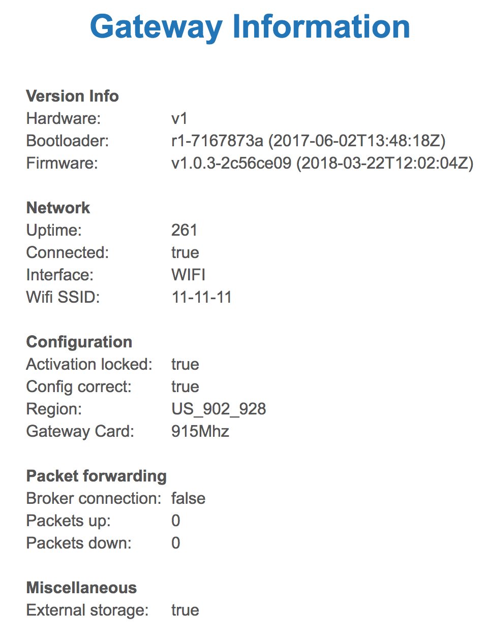

03
Hmmm… yeah, after a power cycle on 1.0.3 I now only get two solid lights, and one blinking.
And in the info webpage I also see “Broker connection: false”
I’m going to leave it for a while and see if it comes good by itself. Else I’ll try a booloader update.
And I can confirm that it won’t accept an ampersand in the WiFi password. I had to use ethernet at one location.

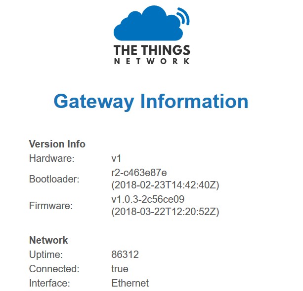

24h
24 hours without one reboot :sunglasses: now
did you have reboots related to MQTT failures? Just curious to know if upgrading for me is useful to do …
