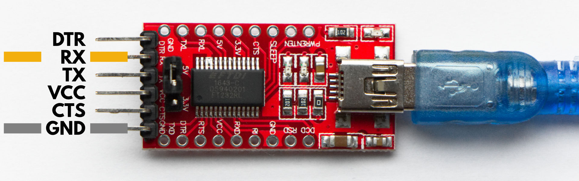

Hi.
I am trying to bring my TTN gateway online. I get stuck in the forth step of activation. What I am currently seeing is LED1 on, LED2 on (online via ethernet cable), LED3 slowly flashing (activating). This goes on for about 1 minute, then reboot of the device and it starts over again.
I have read about the Lora module issue and tried several different fixation methods and also measured contact of the pins between the module and the board. Everything is fine from my point of view. Also the modules LED do shine during the activation.
So I tried to connect to the UART debug port to see what is happening. I have an FTDI-UART-USB converter, I soldered the RX and GND cable to the SUB D connector and connected them to the UART pinout of the TTN Gateway. However, I do see random chars in the terminal (see picture) and no proper text. I even used an osziloscope and verified the baudrate to be 115200.
AND… I have flashed the latest available firmware images from github, but they all behave the same.
What is wrong, please help.
if you have 3 wires connected… switch Rx/Tx
I tried to switch. But if I had connected Tx instead of Rx, I would not see anything, right?
I do see a voltage of 3.3 Volts between GND and RX on the gateway. Can the gateway be changed to 5V?
really ? your lucky if it still works because you put 5V on the UART
Obviously, the FTDI UART converter seems to have a jumper switch for that as seen in this picture from the FAQ. I just wonder if this would make any difference
