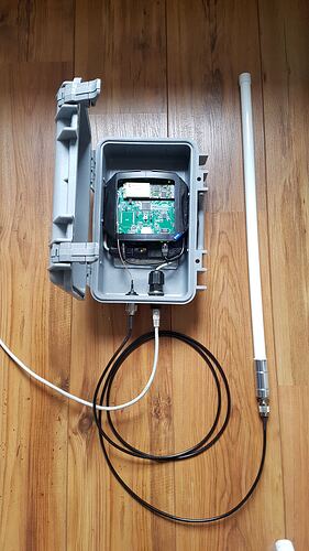

Did you solve the problem with the dropped signal? I’m also having my gateway ready to bring it outside.
Did you take special measure against condensation?
use one of these https://www.conrad.nl/p/drukcompensatie-element-m12-polyamide-lichtgrijs-wiska-evsp-12-1-stuks-530149
and maybe even one of these https://www.conrad.nl/p/silicagel-zakjes-10-g-l-x-b-x-h-80-x-45-x-3-mm-transparant-silicagel-10-stuks-1570671
Q ’ what enclosure is that… alu / plastic ?’
Your setup looks great, good job! (What antenna are you using?) I have not been able to solve the range issue so far. I am suspecting the LoRa card to be defective, and will probably return the unit to the vendor.
@davehellings Regarding condensation: I am relative certain that condensation was not part of the issue I my case. It run for a very short period before dropping range.
