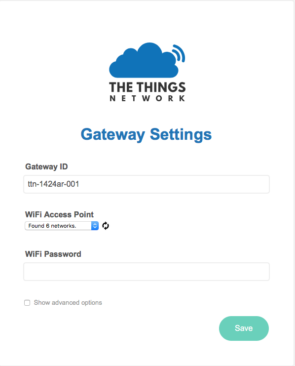

What can I do here, change my WiFi access-point without any authorization?

You are not touching your access point here, you are linking the gateway to the selected WiFi network.

yes i get that, the thing is that anyone on the local network can do this change …
Anybody on your local network can do it. So it is as much protected as your WiFi printer or surveillance camera is.
But I agree that a gateway should be individually password protected as it can send data out of your network.
so what happens when I select a SSID and enter a wrong WPA password, will it fallback to the previously working SSID or will I lose access to the gateway - who knows or tried …
Have not tried this. Based on documentation, I would say that the network connection is initialized once. When you want to do this again, you will first have to reset the TTN-gateway. Meaning: after restart you will start from scratch again. So, no fallback to ā€œpreviously correct settingsā€.
