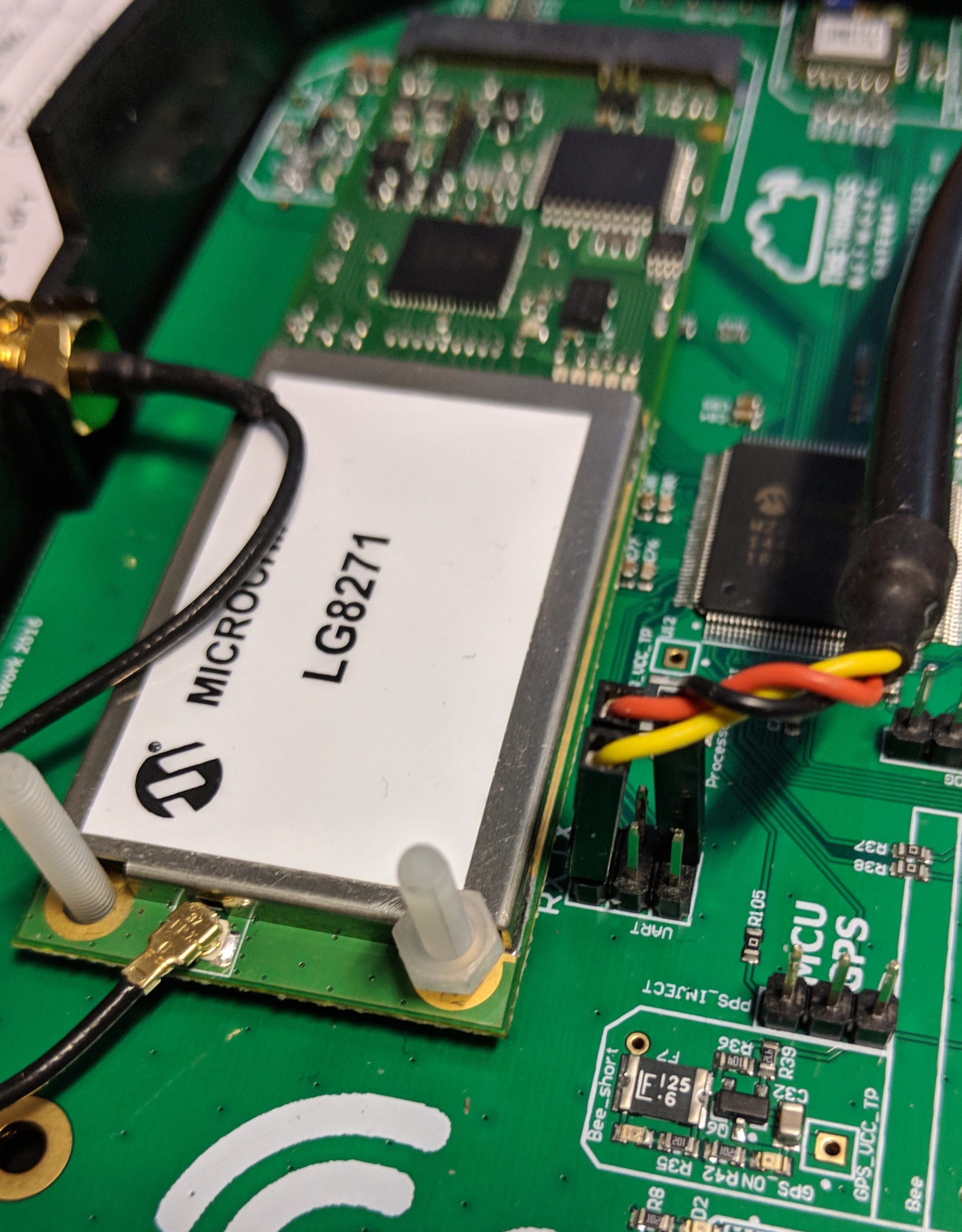

I would follow the suggestion of Arjan. Mine works after I pushed it in a little further.
It also now works with the original firmware.
Stupid enough I made the debug cable afterwards, so I do not have any log of the failing situation.
Yeah. Pushed in and tried at varying angles and pressure points. I’ve even completely removed and blown in the socket and then remounted with a strain-o-matic. Still identical results
Seems like your LoRa module is much closer to the gateway’s PCB than mine. (At the side of the plastic fasteners.) Also, the fasteners look different, or are those the “strain-o-matic” you’re referring to?
That is where I’ve replaced the supplied hardware with screws so I could vary the angle. I tried the original hardware with many different pressures and angles and insertions too
Take care about reseating connectors. They have a suprisingly low life cycle of “removal and reseat”.
https://www.cirris.com/learning-center/product-articles/other-products/227-connector-life-cycles
unless you are sure the connector is the problem, best to leave well alone.

Pushed the reset button a bit harder this time.
Then followed the activation steps again.
But the gateway still not activated.
Led 1 and 2 are on, led 3 blinks slowly, meaning still activating
