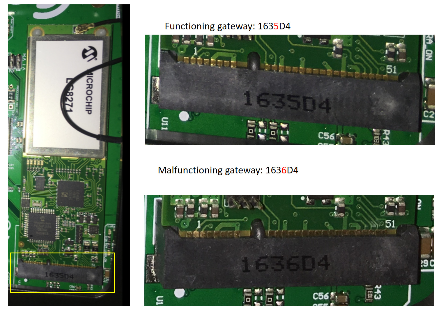

(Marcel Domingus) #512
Hi, my gateway also received an OTA update to firmware “v1.0.1-facdef23 (2018-02-14T08:16:22Z)”.However this still not fixes the reboot loop issue. What I am observing is that as soon as a packet is received by the gateway there is a high probability that it will “crash” and revert to the reboot loop. However, the firmware does improve things somewhat in the sense that after a (variable) number of iterations the gateway will often achieve a stable connection again (previously it would loop indefinitely).
Also, as I have a working gateway AND a malfunctioning gateway, I am wondering if the following difference is relevant: the socket for the LoRa modem of the working gateway has a number etched on it: 1635D4, whereas the socket for the LoRa modem of the malfunctioning gateway has a different number: 1636D4. Can anyone compare this with his own gateway?
See picture below.
(Mbarnig) #513
Hi Marcel,
My malfunctioning gateway has also number 1636D4.
(Dolphin) #514
Confirm, my malfunction Gateway: 1636D4
(Jurrien) #515
Got a malfunctioning gateway too however the socket has number 1635D4.
(Leo) #516
