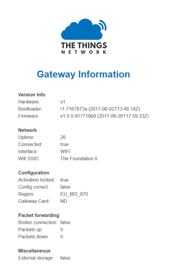

I have the same problem with not possible to activate. WIFI connection seems ok. But third LED is slowly blinking then stops and after 1-2 sec it reboots.
I hope there are other options I can try out.
Thanks!
Perry
Another hint not mentioned before, when i managed to load the /info url in the browser, i only once saw it displayed at : “Gateway Card:”. The rest of the time it showed “Gateway card: ND”. So i guess the communication with the card is not what it should be. Also seen @PerryVanDerMeeren.

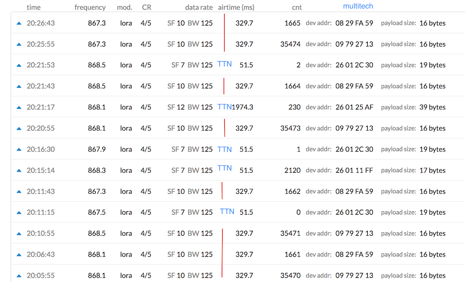

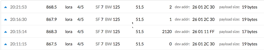

Made a test over several minutes (not so busy when i need it) and see still foreign networks but only on Multitech.
Multitech:
TTN-Gateway:
Seems like the “filtering” is on SF7 rather than on DevAddr… (And that would be a problem.)
There has been no firmware update for The Things Gateway. The current version is from 917719b9 at Jun 26 2017 and there is no logic in there to filter traffic, neither on DevAddr, nor on SF or BW.
Could you inspect the RSSI and SNR values of the messages received by the Multitech vs TTGw?
I’m trying to activate a TTN Gateway but it never activates. I’ve tried connecting via wifi and via ethernet. It seems like it might be rebooting periodically. It cycles from 1.5 LEDs to 2.5 LEDS then briefly to 3 LEDs before all 4 LEDs flash and it starts the cycle over.
Any advice would be greatly appreciated.
Right now the /info page is giving me the following:
Network
Uptime: 26
Connected: true
Interface: Ethernet
Wifi SSID: Things-Gateway-001EC03AF409
Configuration
Activation locked: true
Config correct: true
Region: US_902_928
Gateway Card: ND
Packet forwarding
Broker connection: false
Packets up: 0
Packets down: 0
Thank you

like hdtvisser stated… 'check RSSI and SNR, probably one gateway with an outdoor antenna compared to the indoor TTN gateway, that would explain the SF 7.
hope @bsiege can elaborate on his findings.
Now i placed both gateways with similar antenna (original). I see that the radio reception is slightly better with multitech, but now i have more packets from foreign nodes on TTN-GW too. The filtering seems to be a false assumption on my side. But the thematic is the same. I do not want to forward commercial networks over my internet access. Since they have already 100% coverage here. Best would be if we could do a granular setting for denying/allowing different networks. If not possible at least a switch for “TTN-only”.
