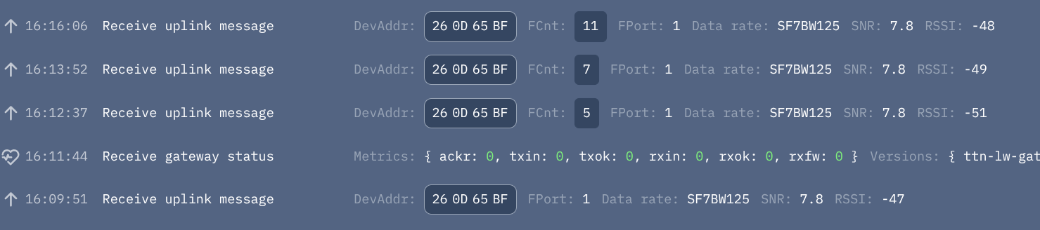

TTN gateway is receiving uplinks but the end device isn't

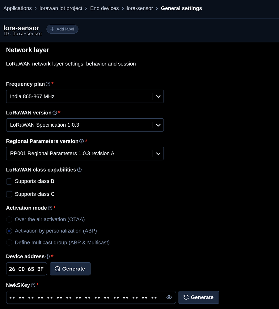

My end device console in TTN(dragino lora shield with DHT11 sensor) is not receiving uplinks although the gateway is receiving uplinks. I used ABP. The NWKSKEY, APPSKEY and device address in my code are correct(msb format and device addr in uint32_t format).
Try switching to OTAA and see how it performs then would be 1st step - assuming you have everying else configured corrrectly, Keys, MSB/LSB, freq plan etc. Also check what spread of channels the received messages at GW are seen on. Which firmware stack are you using? (source link). Signal strength high but not a concern at this point (another meter or two of seperation might be useful). Can you post configs from server and device and any serial o/p from device?
Also change (reduce!!!) uplink rate - just letting it run free hammering uplinks wont solve problem, perhaps add a push to send button then you can see a message in isolation… with such a strong signal and good SNR suprised to see missing fcounts so clearly something else is wrong…
At what frequency are the uplinks received by the gateway? And which frequencies have been configured for the end device?
Both gateway and end device is configured at 865402500 Hz.
Your end device uses multiple frequencies. Which? And what is configured in the TTN console for that device (device settings, Network layer, Advanced MAC settings, did you add any frequencies there)?
I use only one frequency(865402500). I can show you the settings of my device.

This config of you overriding the LMIC settings, particularly the channel settings, is quite far outside the general design & intent of LoRaWAN, so anything could be happening to break the system.
But at the very least, you need to add the frequency you are using to the device on the console.
Or go with OTAA as it sorts out so much of this ‘stuff’ for you.

If you look at the received data in the gateway part of TTN, what is the frequency listed? (Please show the json TTN provides when you click on the received data line formatted using the tools at the top of the textbox.)

This is my internship project only. I am new to this field and I fixed TX_INTERVAL as 30 seconds only for testing this. My intention is to just demonstrate this to my professor. Yeah, I can provide you the json data of uplink.
  "name": "gs.up.receive",
  "time": "2025-06-09T20:53:31.755356560Z",
  "identifiers": [
      "gateway_ids": {
        "gateway_id": "dragino-gateway-iot",
        "eui": "A84041FFFE1BF050"
  "data": {
    "@type": "type.googleapis.com/ttn.lorawan.v3.GatewayUplinkMessage",
    "message": {
      "raw_payload": "QL9lDSaACgABKtE9vIm1",
      "payload": {
        "m_hdr": {
          "m_type": "UNCONFIRMED_UP"
        "mic": "PbyJtQ==",
        "mac_payload": {
          "f_hdr": {
            "dev_addr": "260D65BF",
            "f_ctrl": {
              "adr": true
            "f_cnt": 10
          "f_port": 1,
          "frm_payload": "KtE="
      "settings": {
        "data_rate": {
          "lora": {
            "bandwidth": 125000,
            "spreading_factor": 7,
            "coding_rate": "4/5"
        "frequency": "865402500000000",
        "timestamp": 3318223085,
        "time": "2025-06-09T20:53:31.673762Z"
      "rx_metadata": [
          "gateway_ids": {
          "time": "2025-06-09T20:53:31.673762Z",
          "rssi": -44,
          "channel_rssi": -44,
          "snr": 7.8,
          "location": {
            "latitude": 26.185423425317786,
            "longitude": 91.69131398900774,
            "source": "SOURCE_REGISTRY"
          "uplink_token": "CiEKHwoTZHJhZ2luby1nYXRld2F5LWlvdBIIqEBB//4b8FAQ7aGgrgwaDAjLk53CBhC2zZLnAiDIu4isydoC",
          "channel_index": 7,
          "received_at": "2025-06-09T20:53:31.753182390Z"
      "received_at": "2025-06-09T20:53:31.753182390Z",
      "correlation_ids": [
        "gs:uplink:01JXB7GGZBPFCYVBKRJG21NGZK"
      "crc_status": true
    "band_id": "IN_865_867"
  "origin": "ip-10-102-13-194.ap-southeast-2.compute.internal",
  "context": {
    "tenant-id": "CgN0dG4="
  "visibility": {
    "rights": [
      "RIGHT_GATEWAY_TRAFFIC_READ"
  "unique_id": "01JXB7GGZBT7K8YSX2BAS39YN7"

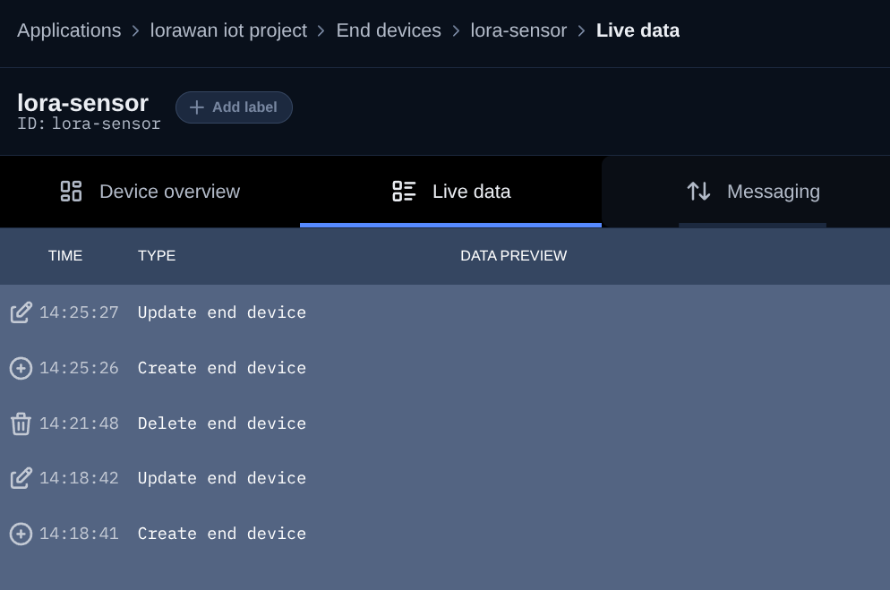

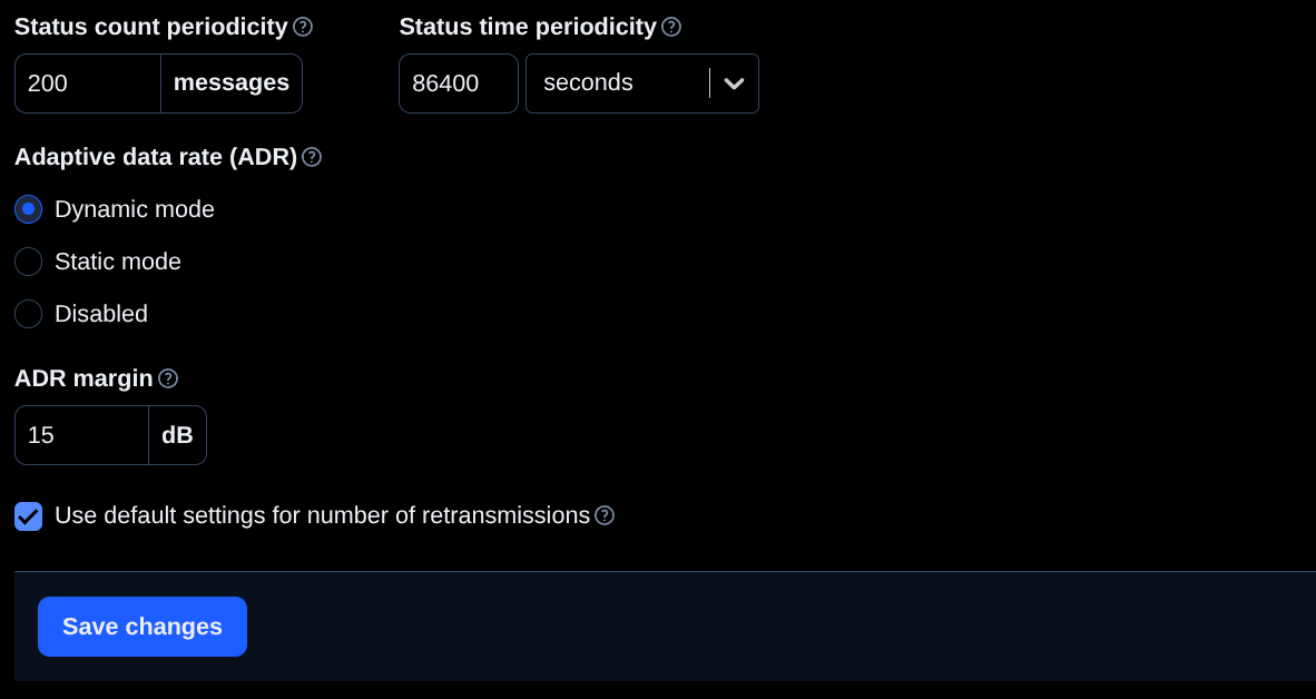

How to add frequency? Do I need to change the Rx2 freq and desired Rx2 freq in advanced mac settings of network layer to 865.4025 MHz?

Add it to the “Factory preset frequency list” - the extensive documentation is well worth reading.
No. You need to learn the basics of LoRaWAN as this is a fundamental.
PS, Please ensure you use the </> tool to format the text/logs/JSON please - you can edit your post to do this now.
The IN865 band does list 865.4025MHz as one of the three main uplink channels, so this frequency looks perfectly fine, without the need to define this frequency as a factory preset channel.
I formatted the code. Please check it.
I added my frequency to factory preset frequency. It didn’t help.
