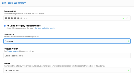

https://www.thethingsnetwork.org/docs/gateways/registration.html#via-semtech-udp-packet-forwarder

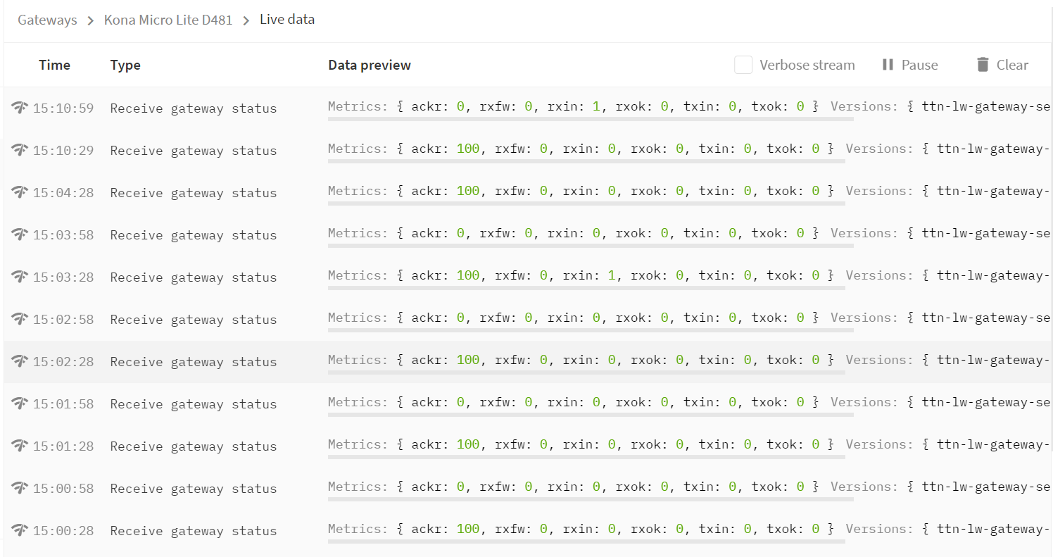

The gateway is up and running. Thanks for your support.
