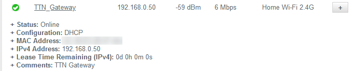

I can see my gateway obtain an IP address:
That confirms it is actually connected to your network. What is the led pattern?
