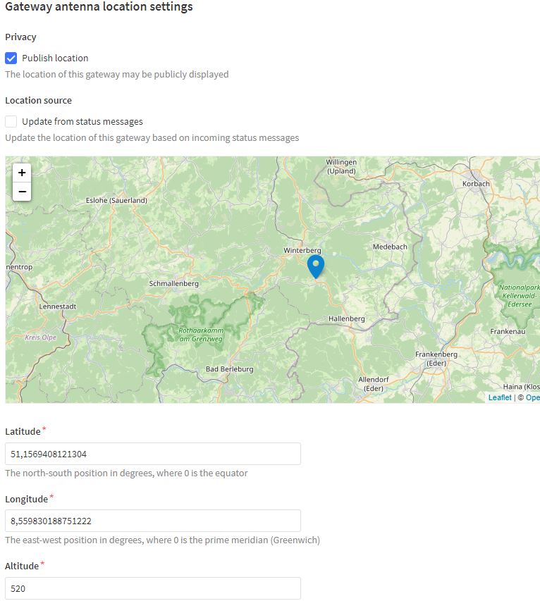

Hello everyone, i have a few questions. It is generally about the TTNMapper. I recently switched my gateway to V3. In general, it all works too. The nodes that are connected send their data and I can see them in the console. Now I have a Lilygo T-Beam V1.1 GPS tracker. With this I wanted to explore the area a little, where there are gateways and where I can receive. Unfortunately, I don’t get it displayed on TTNMapper. Likewise, my V3 gateway is no longer displayed. Regarding the gateway: I entered the gateway as publish location under location and entered the coordinates. The Gateway is a Mikrotik Lora8Kit

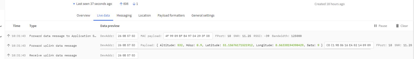

Now to the T-Beam GPS tracker.
Data arrives cleanly and is also decoded. Only these do not arrive at TTNMapper either.
and here are the complete data

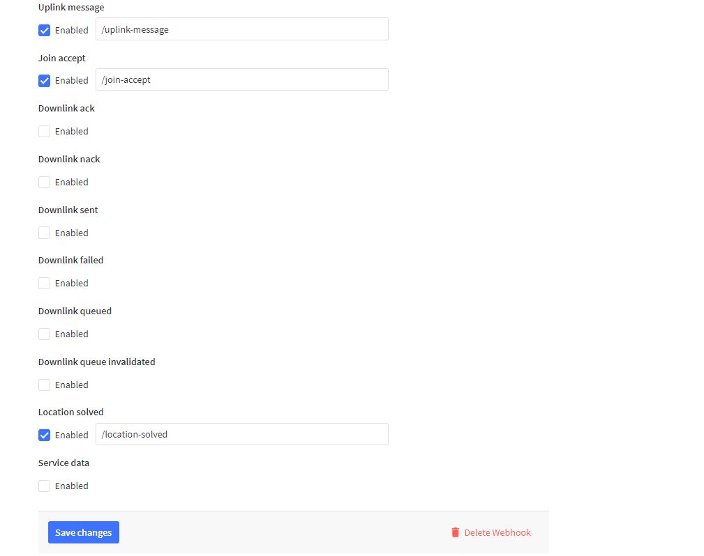

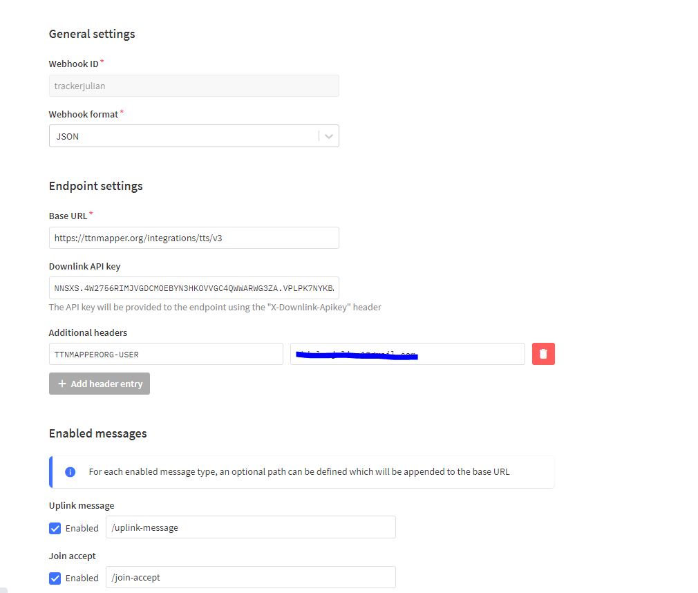

Now also the Webhook:
Who can help me?
