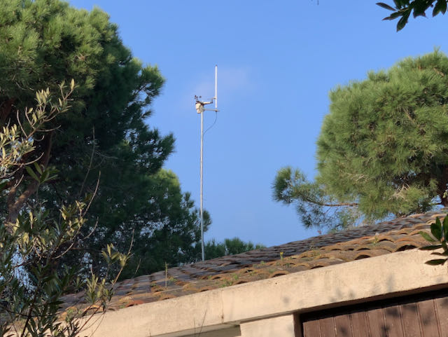

Hello, I’m also in Mataro and am running a gateway here, up in Urb. Santa Maria de Cireres. Currently the gateway is a Dragino LPS8 and is running indoors, but I plan to put an antenna up on the roof.
Not sure I’ll be able to add a huge amount of coverage as my location is about 260metres up, but still in a valley.

I finally got around to mounting an antenna up on the roof! I’m already seeing increased traffic, so hopefully I’m now able to provide much better coverage for the Mataro area - due to my location, I think I’ll mainly be covering the area to the north-east of Mataro centre. Hopefully with some coverage out towards Sant Andreu de Llavaneres too.
I’ll do some mapping with TTNMapper when possible (accounting for COVID restrictions etc), but hopefully this will help make LoraWan more useful in Mataro :slight_smile:
Nice. What antenna are you using ?
It’s the Interline HORIZON 868 - 8V1: antennas and accessories | for wireless networks
I was able to purchase it locally, delivery in 2 to 3 days, seems very well made so I’m hopeful it’ll last well up there on the roof!
http://www.ciudadwireless.com/interline_ih-g08-f8688-v_horizon_0-86»0-88ghz_omnidirectional_antenna-_polarization-_vertical-gain-_8dbi-_connector--p-8712.html

Great stuff, the external antenna has made a big difference these are the results I’ve seen so far using TTNMapper: TTN Mapper
