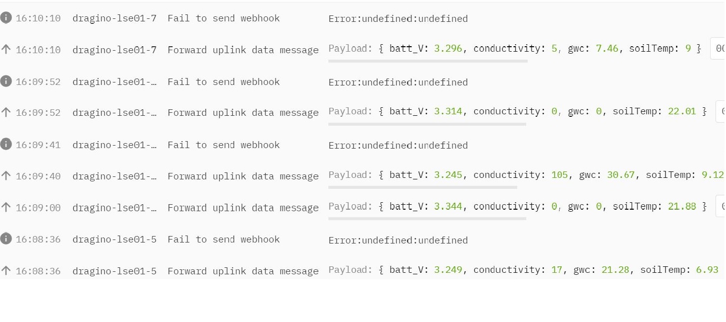

For almost three weeks, I am observing something wrong with TTN. The TTN actually received the message from the sensors and it is unable to send it to our webhook. Did anyone also face the same issue? I get the following error.
ttn-error-2
Any leads would be highly appreciated. Thanks.

Hi Imran, what does the error metadata tell you? Click on one of the error messages to expand and see more… you may get a clue. I’m busy migrating GW’s and nodes to V3 and missed fact one of my early migrations was throwing a similar webhook error. When I checked I saw it was still linking to a temp server set up by Nick @descartes to support the Things Summer Academy…now long since switched off. I simply deleted the errant webhook. You may find similar clues… a malformed/corrupt url, dead service, changed connection/service no longer correctly formatted or whatever… worth a peep. If you don’t understand why you see capture as text (not a picture) and post here for others to assist where poss.

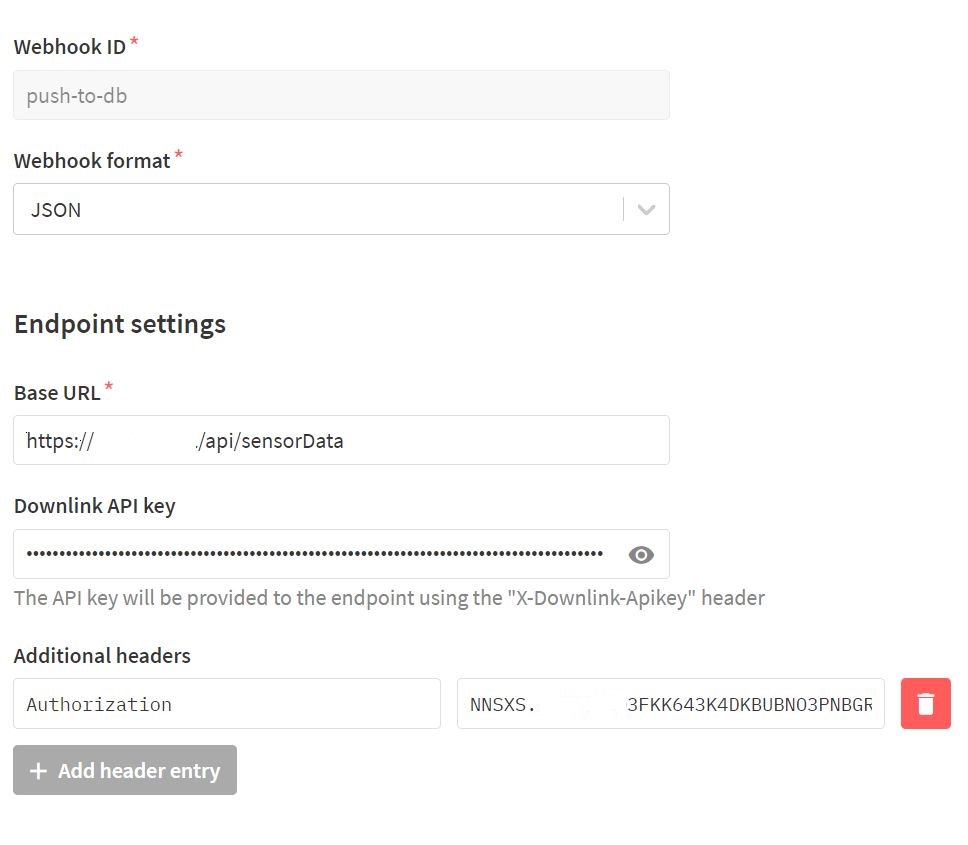

Hi @descartes. It is a simple PHP API. Below is the setting screenshot.
ttn-error-3
Thanks
Hello @Jeff-UK,
Below is the error metadata.
  "name": "as.webhook.fail",
  "time": "2021-10-26T09:51:53.256039533Z",

Why are you including both a Downlink API key and an Authorization header with a TTS key? The first is so you can do Downlinks - the other headers are only for your convenience. Are you using the key to do other things? If so, nice trick. I’m going to use that as it saves embedding the key in the PHP settings!
