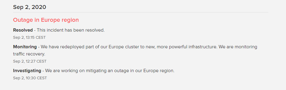

Very strange issue we are facing since 2nd September,2020. MQTT integration not working only for one of my application, it has been working without any issue so far. MQTT settings, access key all are same but no data over mqtt integration from this ttn application. Is there any change or outage for ttn mqtt services in europe region. Please share.
Is it because of this ? image

Hi @CambridgeSensorNetwo, I have just tried a new console connection (W10, chrome) and a new MQTT subscribe (mosquitto_sub -d…) to an existing app with existing devices on EU.
Both are working normally, showing uplink data as expected.
I guess that the fault that you are seeing is only affecting some users or applications or connections.
