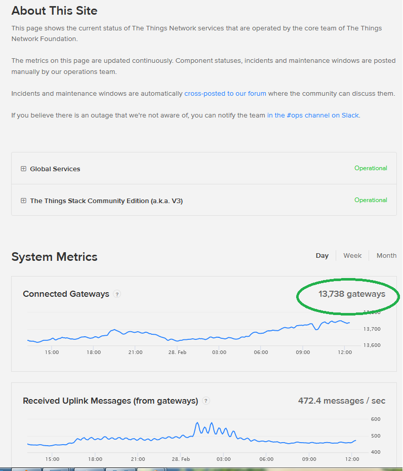

If you look at the TTN global map you can see an interesting statistic called out…
- > Over 70K GW’s connected via PB
Given there are currently around 14K GWs directly on V3* (seen within last 2 weeks) that means a LOT of off network GW’s that will facilitate roaming via Packet broker, most are (I believe) private TTS instances but PB also supports Chirpstack instances etc…
