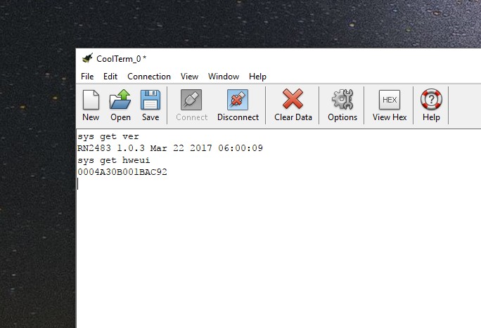

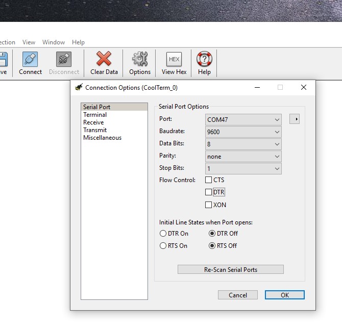

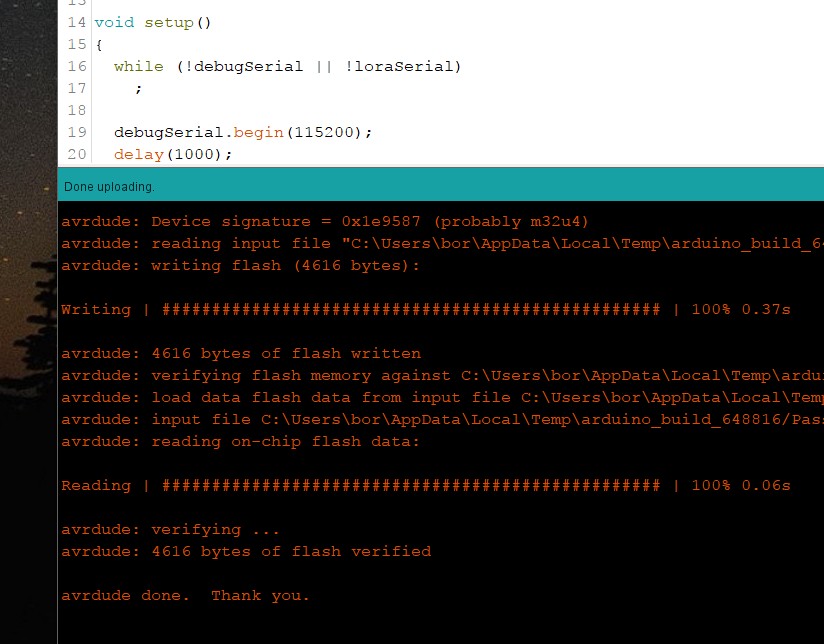

- upload the passthrough sketch to the board
- open a terminal (or use this free program) and see if you can communicate
btw I’ve seen the same behavior before with ubuntu in your log, opening and closing ports, what OS are you using ?
Ah, using the passthrough sketch with command mac get deveui I get response 0004A30B001BB460 ![]()
I’m assuming device EUI I need to register it on the network?
This can’t be the EUI since TTN EUI must be lower case right? What’s the command to obtain the EUI?
Yes, I’m using Ubuntu 16.04
http://ww1.microchip.com/downloads/en/DeviceDoc/40001784B.pdf
sys get hweui
if you get a response your TTN node is not defect, but the combination Arduino IDE/ UBUNTU connected to a 32U4 based module is not functioning as is does under windows
mac get deveui and sys get hweui both return the same string with capital letter. TTN won’t let me connect a node with capital letters in the EUI.
Thanks a lot for your help. I know I’m asking noob questions, I’m just starting out with TTN
that IS the hardware EUI
I did it here with passthrough and a terminal program
you see… the same HWEUI

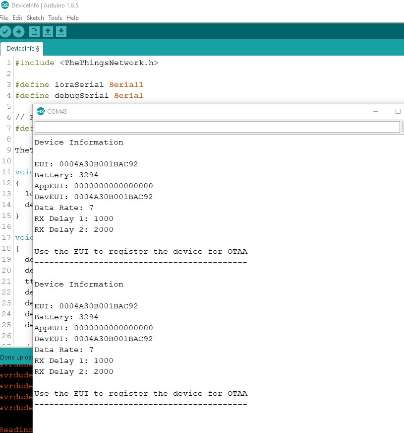

if you (could) run the device info sketch on the TTN node it looks like this on the monitor
so go to the console and create an application and add this device
on the bottom of that page you see Example Code
copy paste that in the basic sketch and upload to the node
that’s it… data should be coming in if you are in range of a gateway
