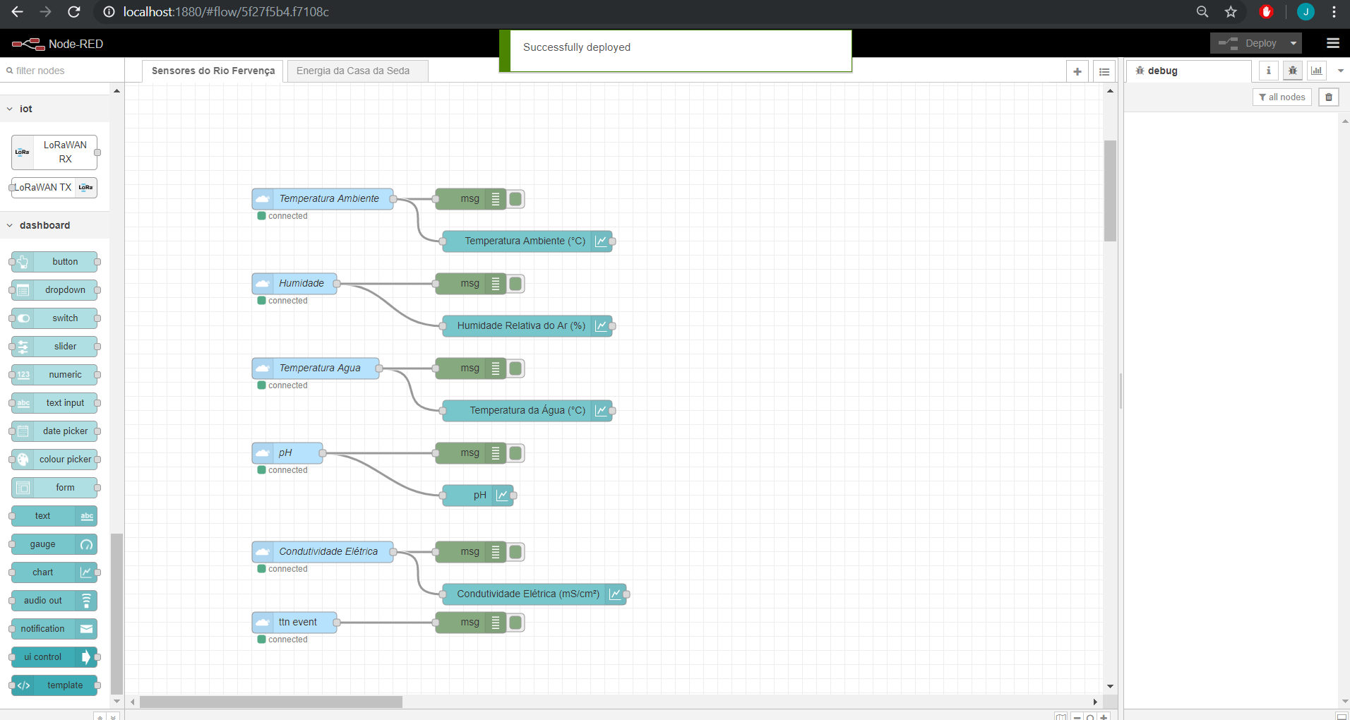

Hello. I’m developing an application using node-red-contrib-ttn to collect the data sent to the TTN server using an uplink node to plot the data in graphics. This was working fine until 2 days ago and now it suddenly stopped working. As you can see on the image attached, the node shows “Connected” status, and I am receiving the messages fine in the TTN console. The debug node shows nothing on the node-red console.
Anyone facing a similar issue or have a solution for this? Thank you very much.
This is verly likely because we had to disable uplink fields on MQTT because those were causing a lot of trouble. We intend to re-enable them when we have found a solution for the underlying problem, but that may take some time.
To work around this, you can empty the “Field” of your “ttn uplink” node, and use a function to select the fields you want from of the object that you will then get out of the “ttn uplink” node.
