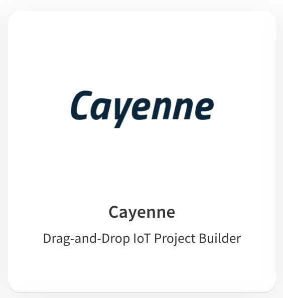

Wot’s this then?
Screenshot 2021-05-27 at 12.02.13
A nice surprise? Christmas come early!? Will have to experiment… :wink:
Did a quick check in between other tasks and yep its there :clap: - so quickly added integration to an existing V3 registered Laird RS186 t&h sensor that was used for early V3 tests and is running fine.

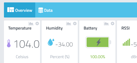

However, where I see payload decoded just fine in V3 console:
There is a problem with Cayenne display that I will need to investigate further when I have a few mins (think I have seen this reported previously with an easy fix but damned if I can find quickly now I need it!)
