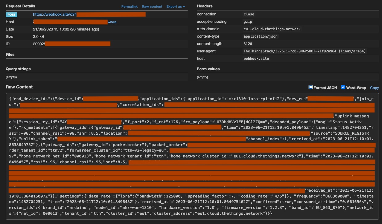

- Creating a new custom webhook in the TTN using as BaseURL
https://hooks.slack.com/services/Txxx/Bxxx/zxxxand ticking the uplink message box by replacing /path/to/webhook with Txxx/Bxxx/zxxx no messages arrived in the Slack channel. - Testing if messages from TTN are sent using the webhook.site ( https://webhook.site ) mentioned by @descartes in thread Webhook and Payload Formatter I can confirm that the messages arrive.
So if messages arrived on webhook.site, why are the messages not being received on the Slack Channel?
Note that I am only interested in the “decoded_payload: {msg: “”}” part of the content.
