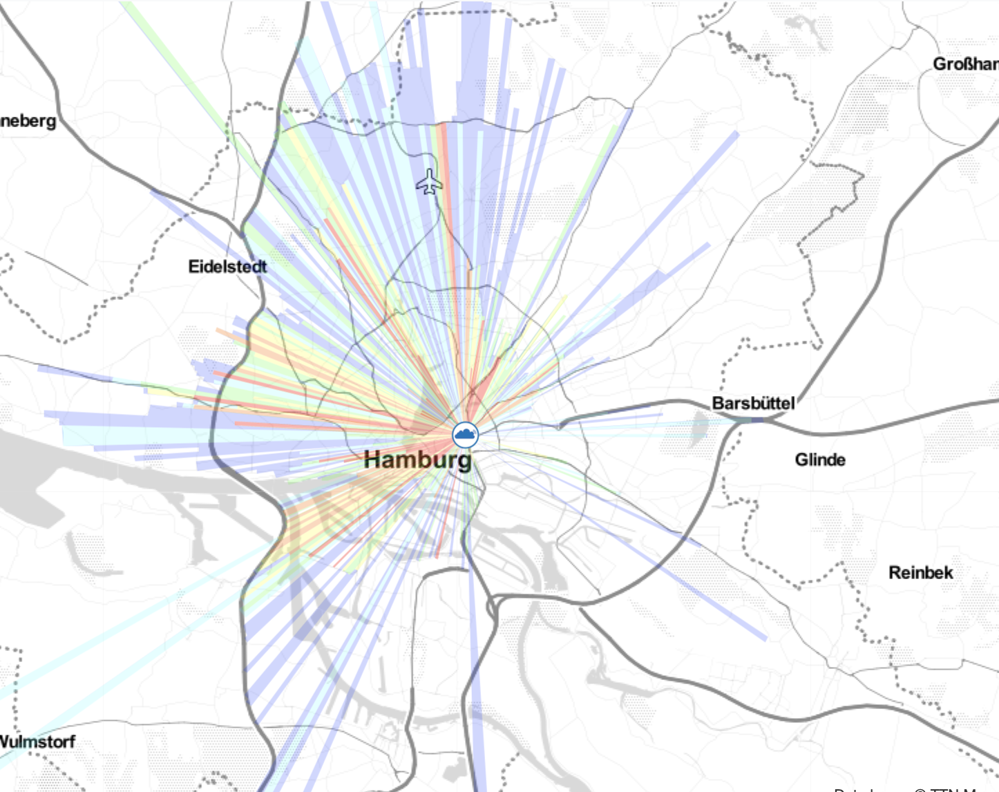

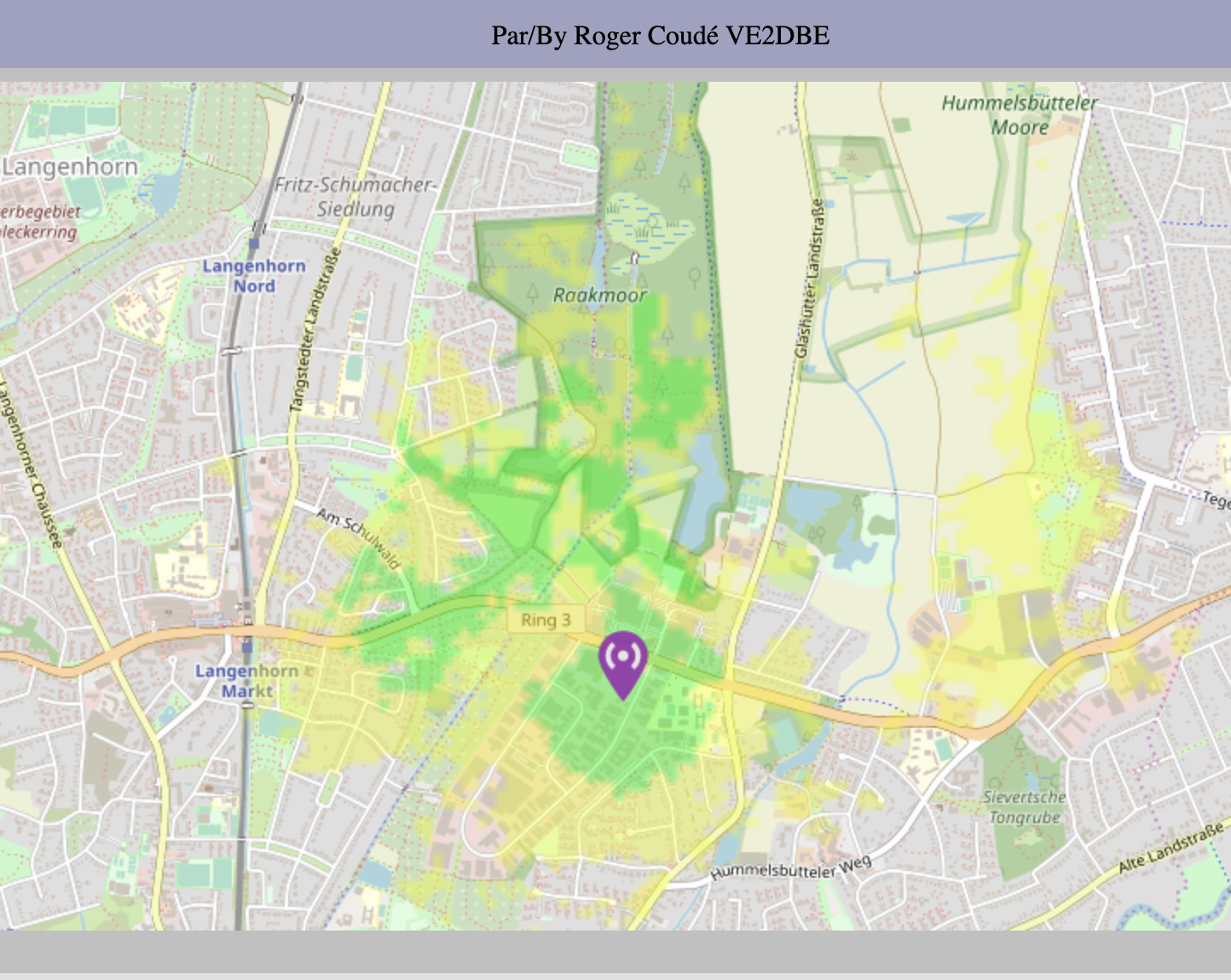

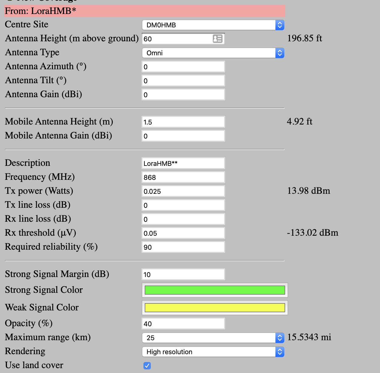

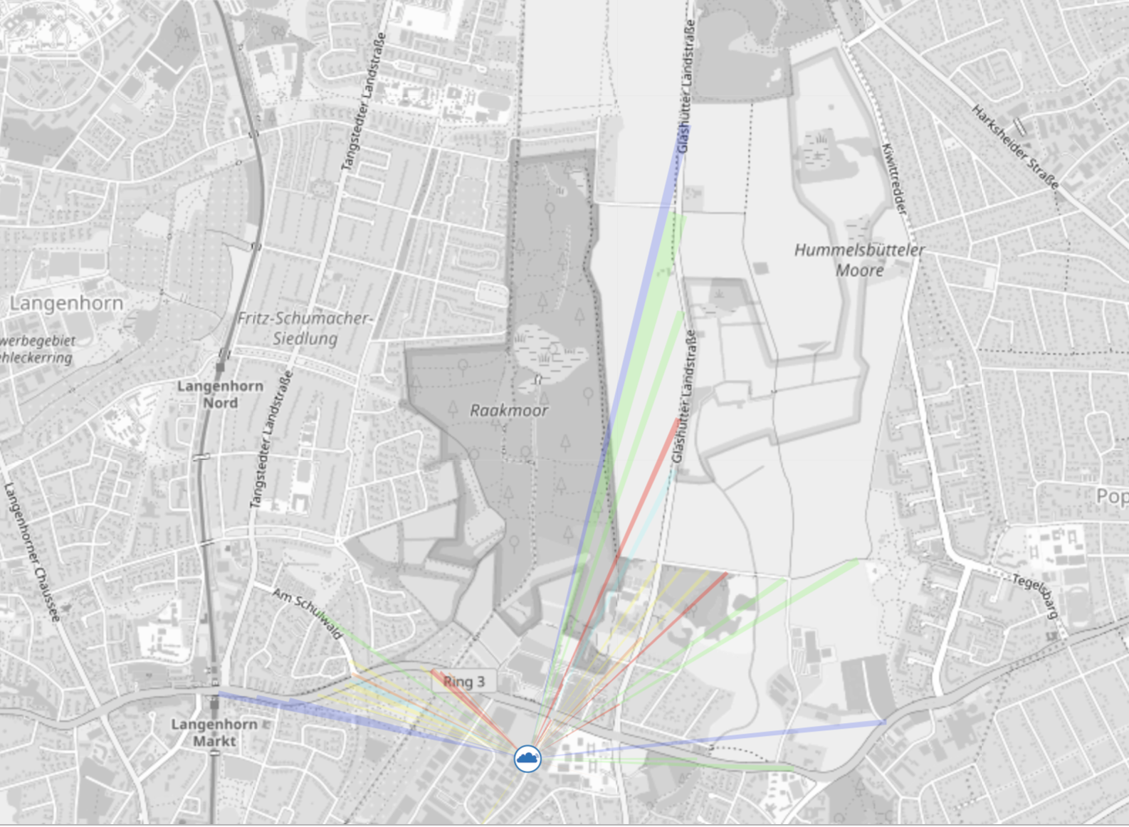

let me add here some sample calculations of my office gateway and of a very good gateway in my city. each time a TTNMAPPER foodprint and my radio mobile calculation. I also add my personal config how i configure radio mobile for lorawan calculations (which are nearly the same as in reality).
Wolf.office_radiomobile radio_mobile_config_lora city_demo_radiomobile city_ttnmapper office_ttnmapper
Thanks, hilltronic for that useful material, which tells a lot about ways of using RMO as a LoRaWan aid.
