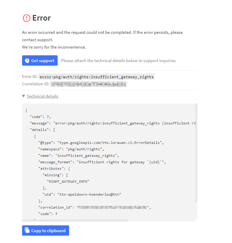

On TTNv3 we created an organisation for our community gateways. All our members are added as collaborators with all rights granted.
  • The member is able to see the gateway in their overview (The Things Network Console)
  • The member cannnot access the gateway details when clicking on the gateway. The following error is prompted
Is this a known bug or are we doing something wrong?

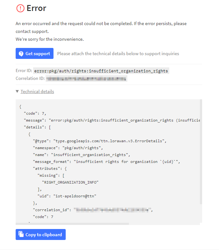

Also when I (as member) try to access the organisation (The Things Network Console) I get the following error message
I suspect your account was granted rights some time ago when we had a bug in the Console that granted application rights on organization members (instead of organization rights). I reset your rights on this organization, can you try again?
Awesome. That works! Thanks
