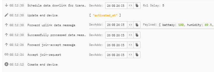

However, interestingly, I tried adding a device using csv file upload and that worked flawlessly! :slight_smile:
So, I have a means to achieve the end-result for now but can confirm that the UI way isn’t working after the upgrade.
