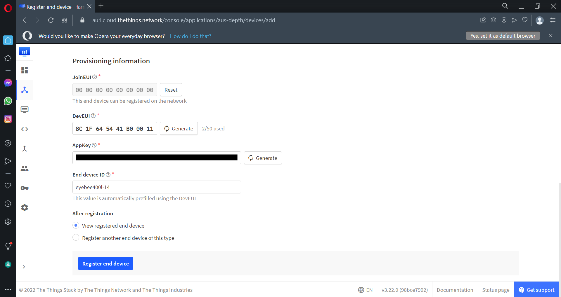

Thanks @descartes for checking it out on your console. This is pretty frustrating: not being able to figure out what’s causing this.
I have now tried adding device (manual option) on:
a. Edge, force refresh and incognito
b. Chrome
c. Opera browser (first time use)
I can confirm that this is NOT working on these browsers for AU region for me, (have not tested any other region yet)
However, interestingly, I tried adding a device using csv file upload and that worked flawlessly! ![]()
So, I have a means to achieve the end-result for now but can confirm that the UI way isn’t working after the upgrade.
It’s probably some cached js file someplace, but it does not look like a cache issue at on the browser-side.
