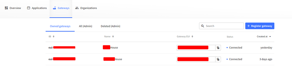

I removed 2 of my gateways from AWS and connected them to my local instance and they do seem to be connected correctly:

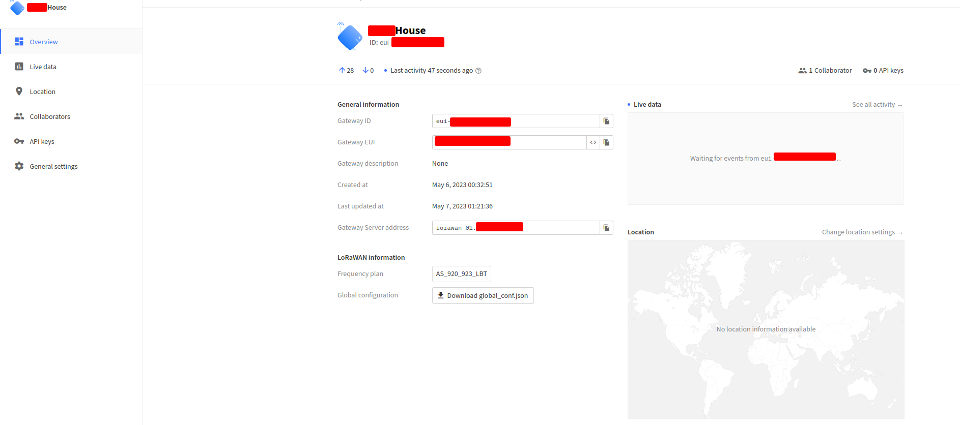

Here is where things get a bit strange:

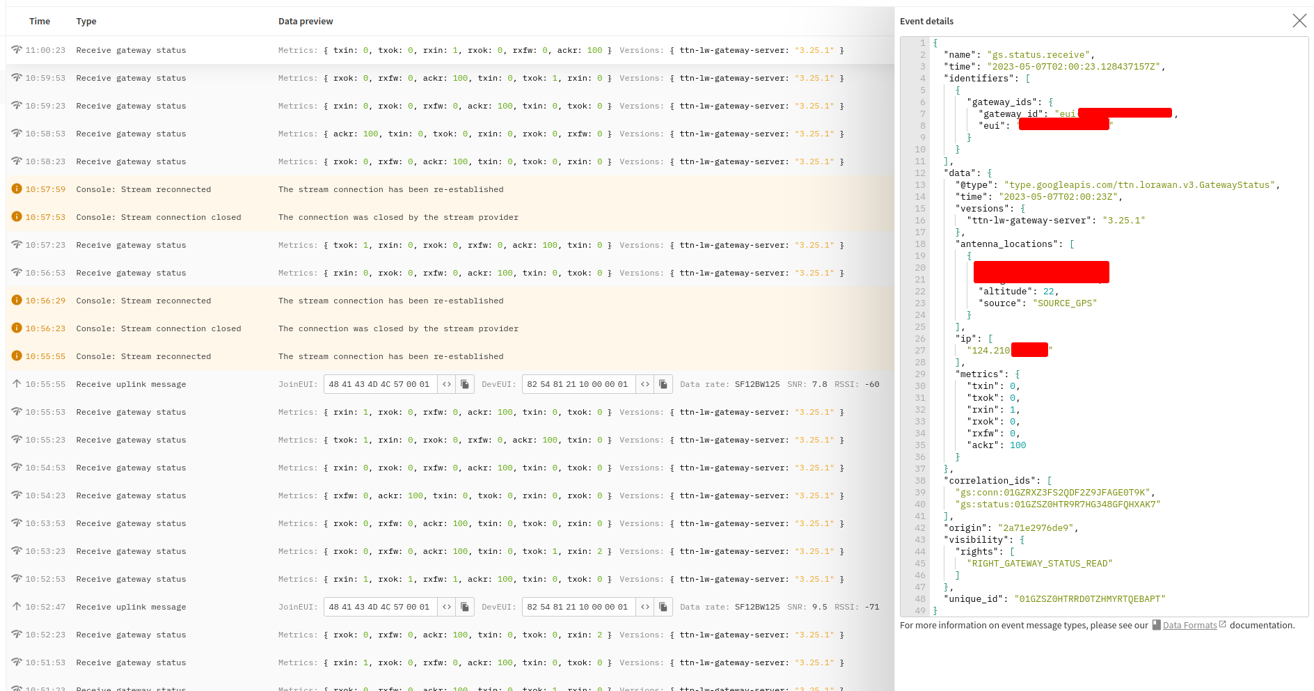

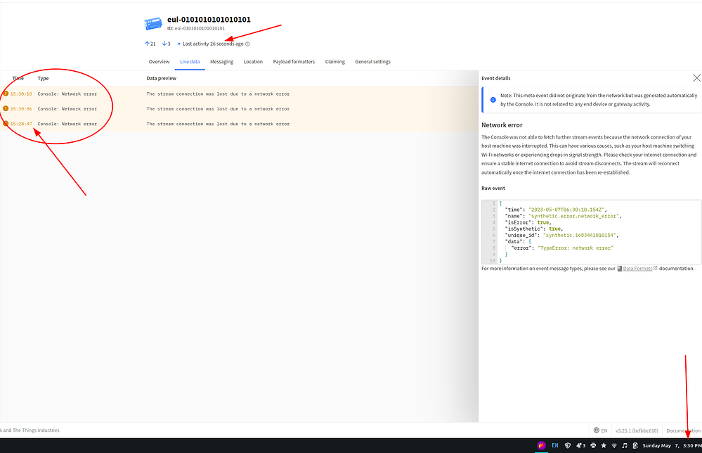

This is an image of what I see after sitting on the gateway page for abuot 5 minutes. the âLast seenâ counter keeps resetting, however I do not see any data. very strange.

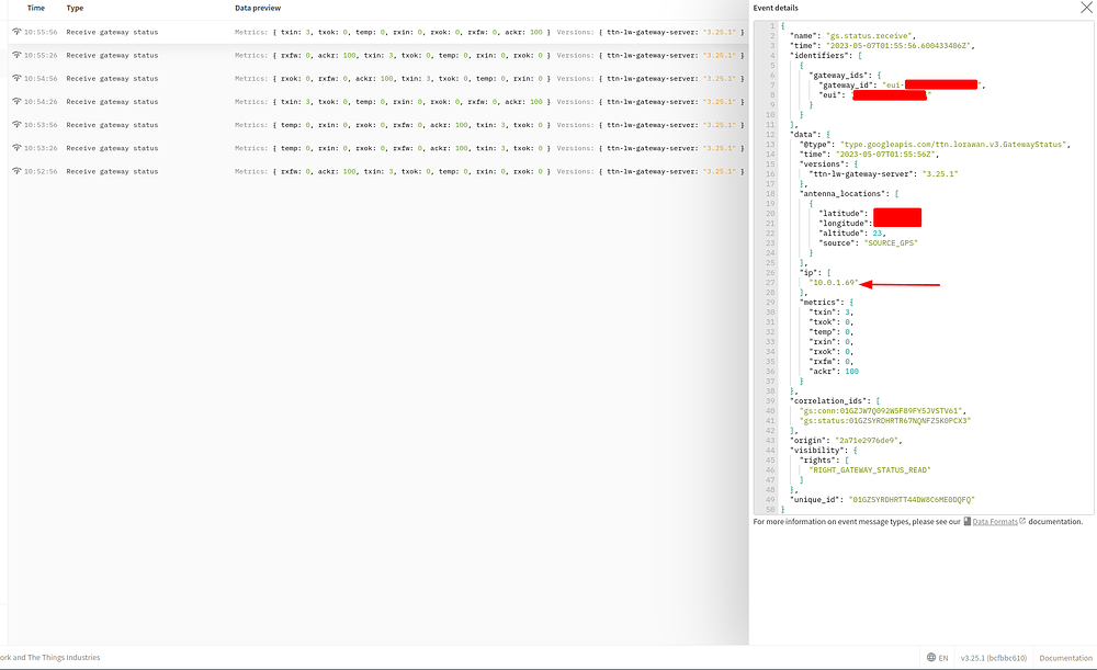

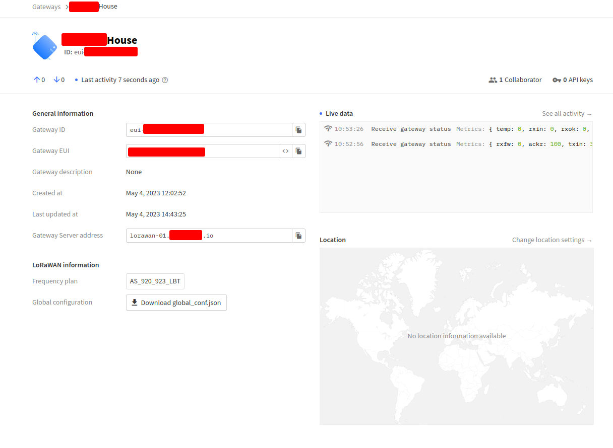

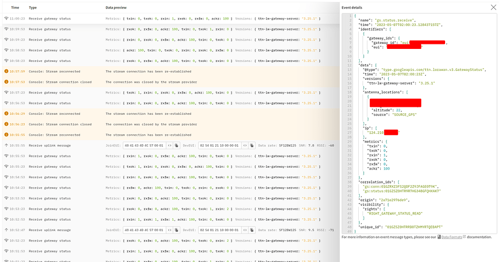

Then If I connect my computer via VPN to the network that the server hosting TTS is on, i see this:
we have data!
but⌠why are we not seeing data without the VPN? Could be a port issue?
Here is the data from the gateway message:
IP Address 10.0.1.69 is the address of the gateway running on the same network as the server.
Here is data from the 2nd gateway:
That gatewayâs IP address is elsewhere on the internet and I see the same stuff, I can view data when on the VPN, but see nothing other than the couner reset when not. This makes me think again that it is a port issue.
the interesting thing is that the gateway does show a device that has sent data, however that device data never makes it to the application that it is registered within.

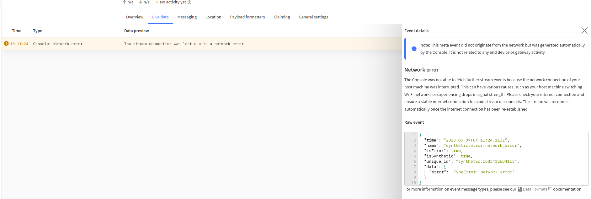

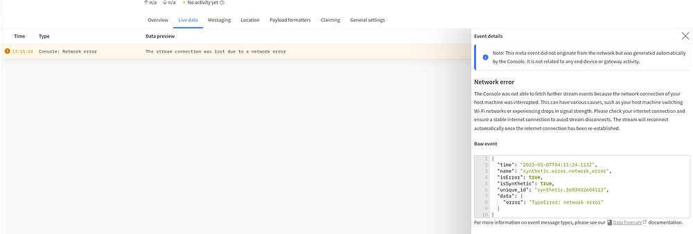

In the device page, I see this error:
However, after searching for the error:
synthetic.error.network_error
I did find: Status of our TTG gateway is disconnected - name": "synthetic.error.network_error",
Though, I am sure I donât have the ID duped, as I have only entered it once. Could this be because it is entered in my other instance still running on AWS?

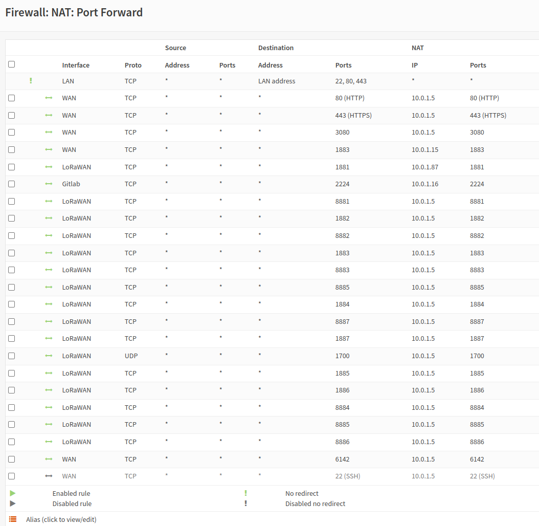

I am pretty sure the ports are all opened in my firewall though, it seems like they are not:
The ports in this image open the ports to the box running the reverse proxy, though I have also tried the one running TTS. I may change it back to see if there is another change.
