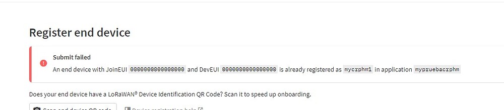

I haven’t added an end device for a while and I am adding to a new account. However, on the web interface I keep getting: “Submit failed, no DevEUI specified”.
I have double checked I am using the correct data. I have also tried using zeros for the JoinEUI and then I get: "Submit failed, an end device with JoinEUI 0000000000000000 and DevEUI 0000000000000000 is already registered as xxx in application xxx
Despite putting in the correct number in the DevEUI box.
So it looks like my DevEUI is being blanked. I’ve tried different browsers and OS’s.
What am I doing wrong? Any help greatly received. Thanks!
