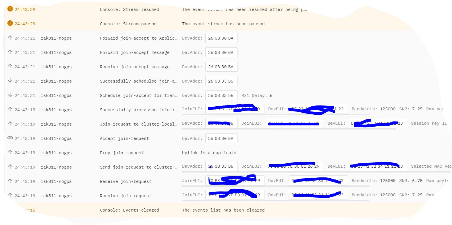

See below re my first V3 device, done as above - this is a full join via V2 gateway but processed by the V3 backend (note the uplink duplicate line and two join requests), that’s because I have two gateways here onsite)
join

I cant test at the moment but it maybe the logic that if the credentials match in V2 then it performs the join request and issues a V2 device address etc, if the device doesn’t exist in V2 then V3 does the join accept and issues a V3 device address but all via the V2 gateway - I agree you can’t have both trying to compete so some logic must exist.
No need to test, that is exactly what happens. And it is designed to work this way to allow gradual migration (no big bang).
That’s indeed the first part. After this, you need to make sure that V2 no longer accepts joins. You can do that by deleting the device from V2, but that would make your device stop working immediately. Instead, you can change the AppKey in the V2 console, so that new joins will no longer get accepted by V2, but the existing session is not deleted yet.
