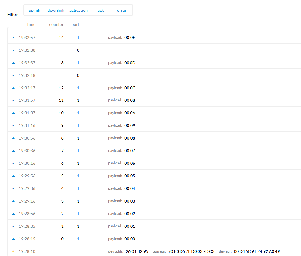

in my test, after join i send 12 packets to ttn with no anwer. at counter 12, 13 ff ttn generate a uplink an i can receive it in RX0. why is it different from 0-12 than after?

As kersing suggested, data communication over LoRaWAN usually works without answers. The device just sends data data. There is only sporadic bidirectional communication as part of the ADR algorithm, see here: https://www.thethingsnetwork.org/docs/lorawan/adaptive-data-rate.html
Your LoRaWAN stack on the device handles this internally and the application running on your device probably isn’t even aware that it is happening. You can recognise this traffic in the gateway console by it port number of 0. You cannot really tell why exactly the network decides to send ADR packets at a particular time, but you can now inspect the contents of ADR packets in the v3 console if it interests you.

I just want to know what it’s all about and why data packets are being sent that I don’t need.
OK, I understand, ADR requests. But with every package? Isn’t that unnecessary trafik?

That happens if the backend notices you device doesn’t respond to the instructions being sent. What hardware and software are you using?
i use original ibm lmic. In buildDataFrame() on any packets (after 12 at begin)
if( LMIC.ladrAns ) { // answer to ADR change
LMIC.frame[end+0] = MCMD_LADR_ANS;
LMIC.frame[end+1] = LMIC.ladrAns & ~MCMD_LADR_ANS_RFU;
end += 2;
LMIC.ladrAns = 0;
ADR ist processed and LMIC.adrChanged has 0x87. Is this not the response of ADRchange?
