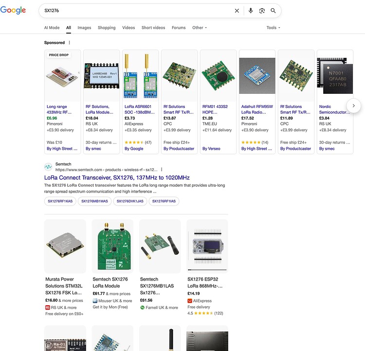

The standard blue SX1276 module that is the first thing that comes up when you google “SX1276”.

You’re kidding right? Google tailors the search experience and there is no ‘standard blue module’ as there is no standard for the modules.
Here’s what I see:
This thread will be closed very quickly if this is the sort of response that you are going to provide the volunteers taking time out of their day to answer you.
Sorry my bad. Here is a link to the one that I mean (not actually where I bought it from).
https://www.aliexpress.com/item/1005005453557786.html
I couldn’t find any apparent model number and just assumed it was pretty ubiquitous.
My browser is not configured to save cookies. Clearly our search results are very different! :sweat_smile:
