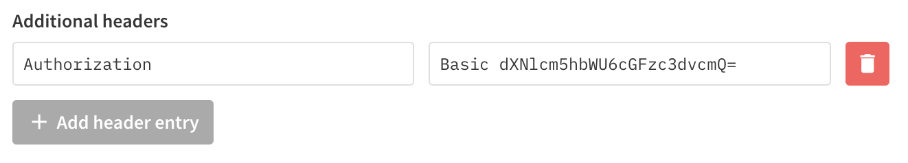

It would look more like this:
Screen Shot 2021-10-11 at 17.23.16
The name of the header is “Authorization” and the value of the header is “Basic” followed by a space and then the base64-encoded username and password.
This base64 string can be constructed as follows:
% echo -n "username:password" | base64
dXNlcm5hbWU6cGFzc3dvcmQ=
Or if you’re comfortable with an online tool, there are several online base64 encoders, you can even ask your search engine to encode base64.
