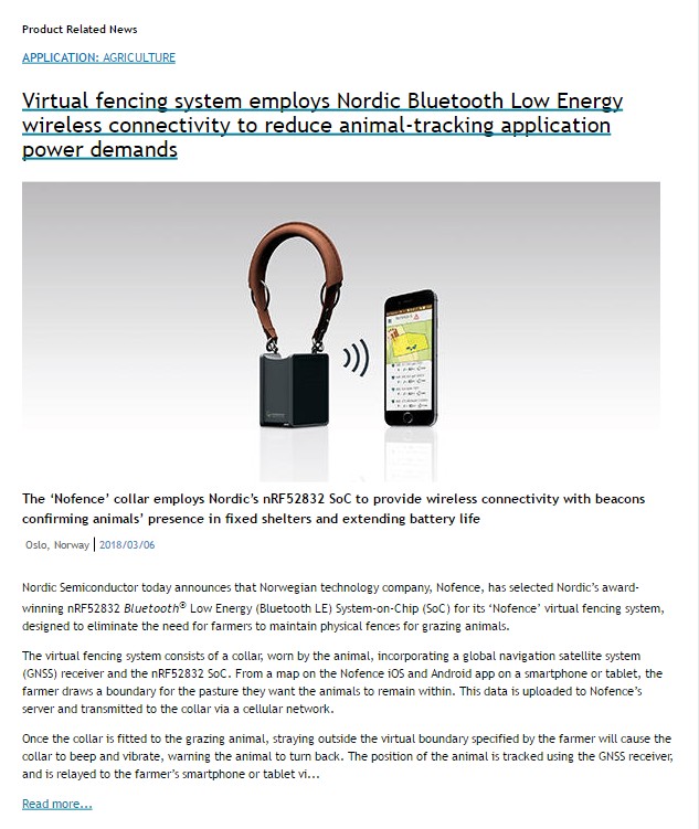

today received this mailing from NORDIC… virtual fencing
what about a combination of technologies ?
virtualfencing
