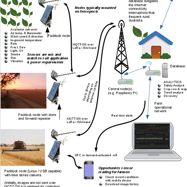

This is one interesting use case in agriculture:
I wonder if any of the team members of the SentriFarm have joined this forum to share with us their experience and lessons learned in this project.
