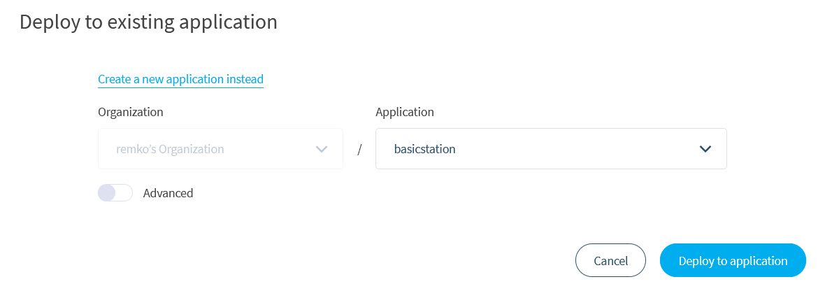

[SOLVED]
I just got info from twitter that the repository was updated with the right certificate. It works now for me.
Awesome, does this means device will self update or do we need to build new image and flash back SD card?
From this site (Deploy a Basics Station The Things Network LoRa gateway with balena) I followed the link to deploy basics station using their template: balena dashboard
There I “deployed to existing application” where I chose my previous created application:
Now the existing Balena deployments are being updated with the new repository.
In my case, all existing settings were kept and the docker containers was updated.
Oh yes thanks, to the trick : deploy to existing application. That did the job :slight_smile:
