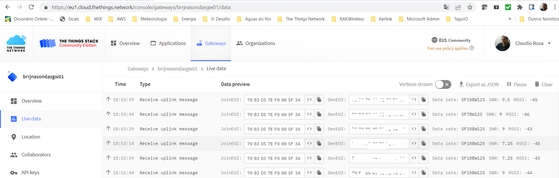

I am having the same problem in my TTN Gateway. I mean, I am seeing the VE.Direct LoRaWAN join request, but no answer.
As we don´t have any kind of documentation about it, I suppose that for communication between TTN and VRM we have a API doing this job (communication TTN <==> VRM). How we can check if this API exist and it is working or not? Take a look in the screen captured below:
The major point is the VE.Direct is not a LoRaWAN compliance device, I mean the design and behavior don´t follow the LoRaWAN expected behavior (DevEUI, AppEUI, Appkey, etc…). Victron did the most difficult thing for a easy task that any teenager with a arduino spend five minutes for connect a new LoRaWAN compliance device.
