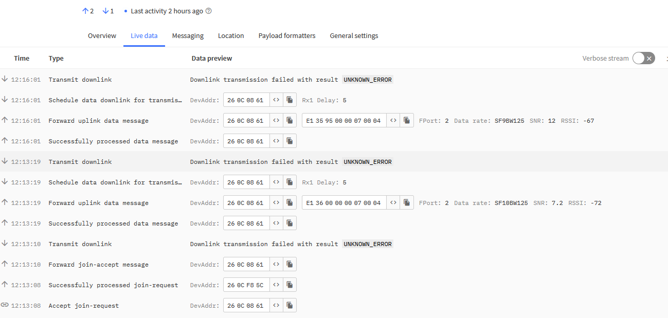

Im getting the message “Downlink transmission failed with result UNKNOWN_ERROR” after to get an forward uplink data message, this event is always, I’m not scheduling any downlink to transmit

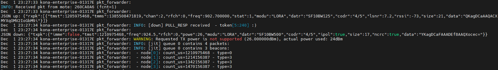

I got this on the console showing the pkt_forwarder.log
it sometimes appears after to send the uplink
here is the json from the gateway console:
"txpk":
"imme":false,
"tmst":1210975468,
"freq":924.5,
"rfch":0,"powe":26,
"modu":"LORA",
"datr":"SF10BW500",
"codr":"4/5",
"ipol":true,
"size":17,
"ncrc":true,
"data":"YKagDCaFAAADEf8AAQXocec="
and this is the Json from the TTN “live data”
  "name": "ns.down.transmission.fail",
  "time": "2023-12-01T23:28:42.712849523Z",
  "identifiers": [
      "device_ids": {
        "device_id": "desarrollo-nodo-eqysr000007",
        "application_ids": {
          "application_id": "pdxl-01"
        "dev_eui": "0080E10A00000007",
        "join_eui": "0101010101010101",
        "dev_addr": "260CA0A6"
  "data": {
    "@type": "type.googleapis.com/ttn.lorawan.v3.ErrorDetails",
    "namespace": "pkg/networkserver",
    "name": "transmission",
    "message_format": "downlink transmission failed with result `{result}`",
    "attributes": {
      "result": "UNKNOWN_ERROR"
    "correlation_id": "32eebaaa260d4d3a8837cb67dbd1c0c9",
    "code": 2
  "correlation_ids": [
    "gs:tx_ack:01HGKVD1PQ9W8KP7X53B5V0VV2",
    "gs:uplink:01HGKVD17X354J44PGSEJ2NH1B",
    "ns:downlink:01HGKVD1MSFNH3XJXFXW3QWCGZ",
    "ns:transmission:01HGKVD1MSTM0DCKZYNXHCHD78"
  "origin": "ip-10-101-7-99.us-west-1.compute.internal",

I thing that I have the “TX power” parameter in the Gateway with a bad value becouse I got in log the message
WARNING: Requested TX power is not supported (26.000000dBm), actual power used: 24dBm
