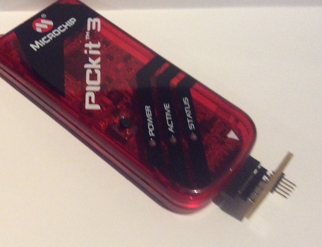

File RN2483-v101.for.ICSP.hex is for use with PICkit3/ICD3 or other compatible PIC programmer (chip is PIC18LF46K22, 3.3V device). RN2483-v101.for.bootloader.hex should be usable with the bootloader available for the 1.0.0 update.
I’ve used the ICSP version because this file fixes the boot loader as well as update the firmware. Used a simple PICkit3 to RN2483 programming adapter to connect to the RN2483 pins.

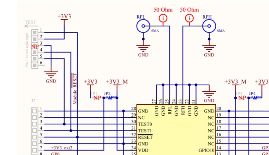

(Jan-Willem Ruys) #11
Amazingly the answer was in the data sheet :smile: - it shows a “test” connector which had the exact pinout of the PickIt. This is the ICSP programming port.

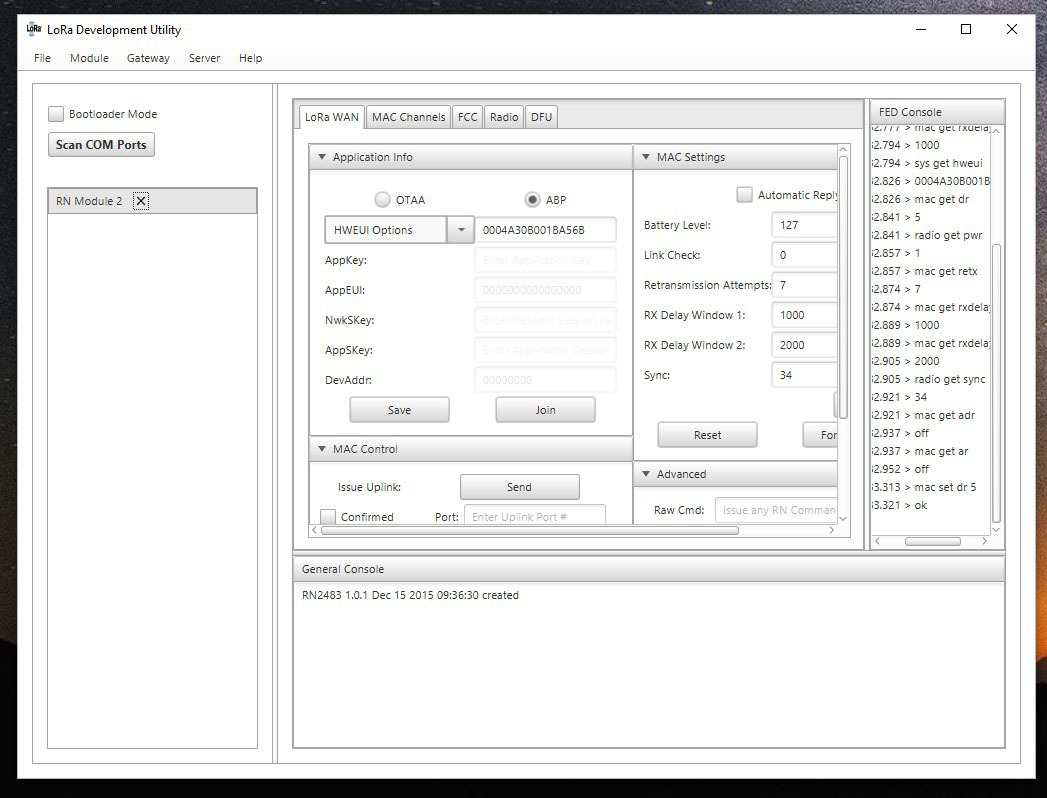

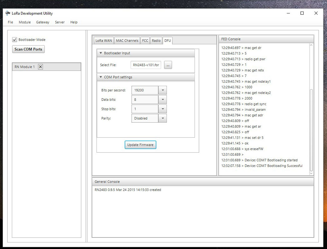

I just tried it ‘the java way’ and it worked :smile:
must be my lucky day.
#13
Found out that programming with the java tools works if activate the reset on the RN2483 and direct after that press scan com ports. Else the software never finds a module in my case.
After updating to 1.0.0 the reset action is not required any more because it finds the module on every scan.
Also updatet to 1.0.1 but after that the scan com ports finds no module…revert to 1.0.0 and it’s working again.
#14
after the update first disconnect/connect and restart java prog before re scan
#15
You havo to click on the “RN Module X” when found, than it will open the LoraWAN…DFU Tab on the right.
