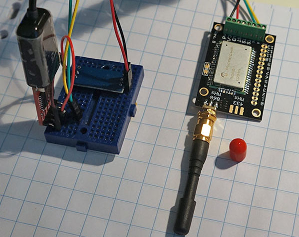

I connected it from a workstation USB port directly to the miniUSB port on the node
ok⦠I worked before with that tool but with an rn2483 connected through an usb 2 serial module
that worked ⦠sometimes, on 9600.
I can imagine that the uart connection between the processor and the rn2483 should be broken to prevent problems during upload

It isnāt. The tool is written to be used with a device where the controller forwards USB data transparently to the RN module, not to talk to an Arduino bootloader.
You need to create a sketch that reads USB serial data and forwards it to the RN module and takes the RN module output and sends it to USB, then you might be able to use this tool to update the firmware.

If you have any free Arduino Zero or ESP32 available you can upgrade with this tool and some basic wiring.

It should be possible with dedicated sketch acting as passthrough between USB and Module, but need to write code on computer side. Amazing we canāt update node Lora RNxxxx firmware easy way
You have to load the āserial passthroughā sketch onto the TTN node to map the serial connection to the RN2483 chip in order to upload the firmware.
I successfully updated āthe things nodeā RN2483 to version 1.0.3. Instructions here: HowTo: Update RN2483 Firmware on āThe Things Nodeā to prevent excessive battery drain
