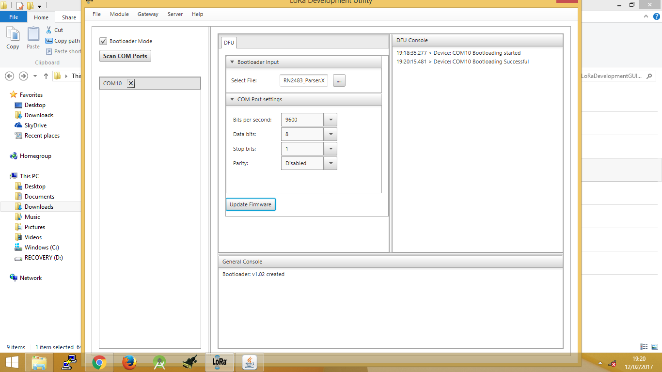

@BoRRoZ Thanks. Your upload kept me going ! I could neither make it at 57600 nor even at 19200. Luck struck only at 9600. Huh !! :slight_smile:
Hope this helps someone.

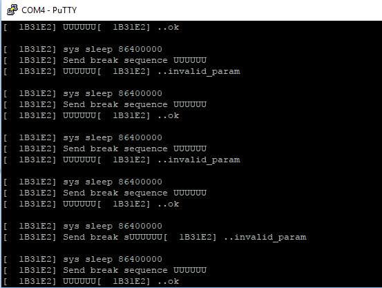

I upgraded to firmware V1.0.3 and tested with sys sleep command. It doesn’t work as I expected, so I dont know if they fixed this issue with new firmware.
When I sent sys sleep 86400000 to rn2483. It replied ā€œinvalid_paramā€, and then ā€œokā€, and later ā€œinvalid_paramā€. It kept going like that. Can someone confirm this one or did I miss something ?
Thank you
The invalid_param response is caused by the ā€˜UUUU’ characters you used to wake the device in the previous attempt. Only one 1 needed, additional ones will be in the command buffer resulting in the command looking like
ā€˜UUUUUsys sleep 86400000’ which the module does not recognize to be a valid command.
You can resolve this on two ways:
  • just send one U
  • if you want to send multiple (not a bad idea), send an additional line termination ā€˜\r\n’ as well to clear the command buffer (this will get you an invalid_param response, just read it and ignore it)
BTW. There is no need to post screen shots of putty output, you can just cut-and-paste the contents of the terminal window into your message. This allows the forum to index the contents of the screen shot as well.
(Make the text a block quote [the " symbol] for readibilty)
