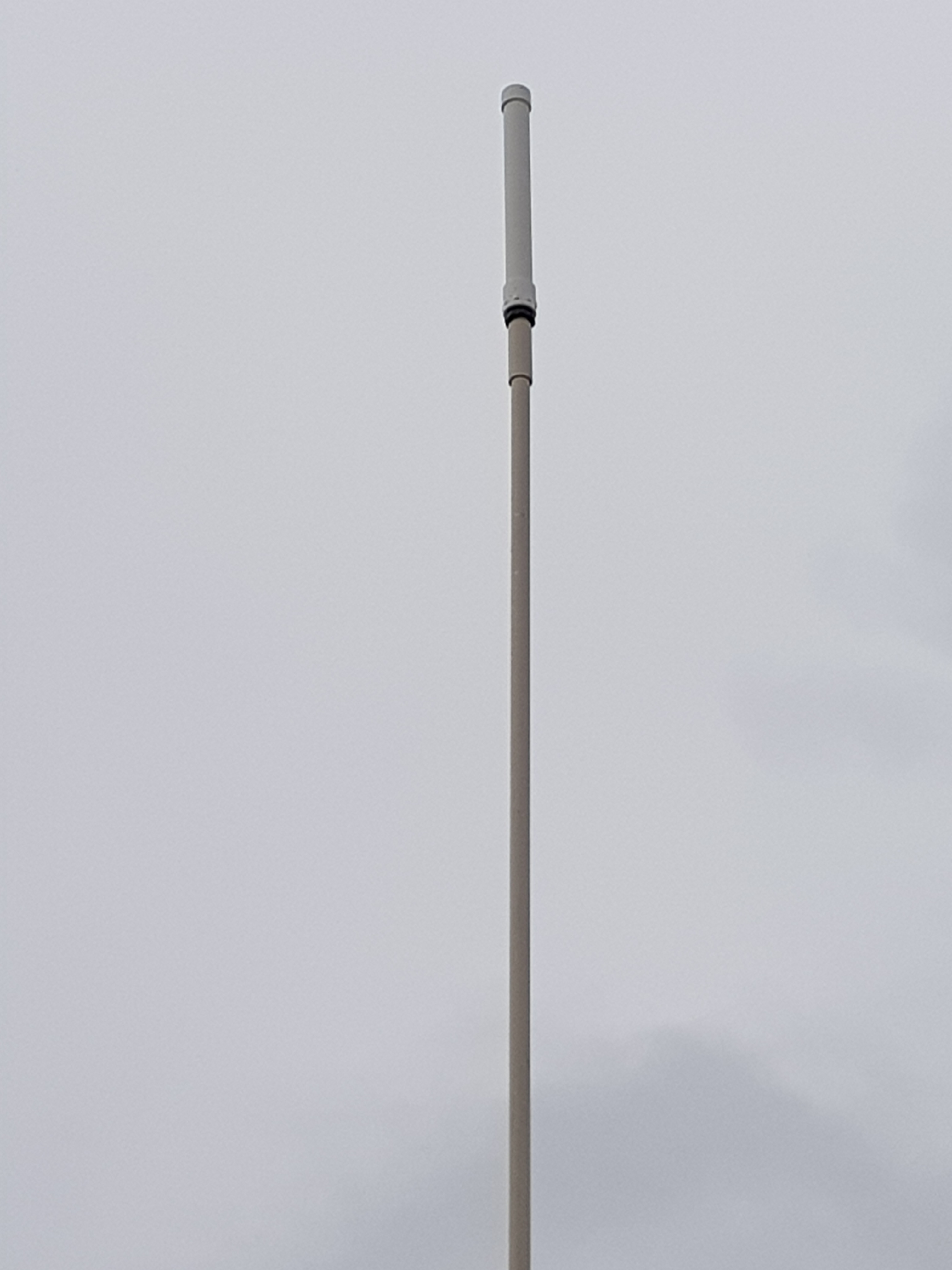

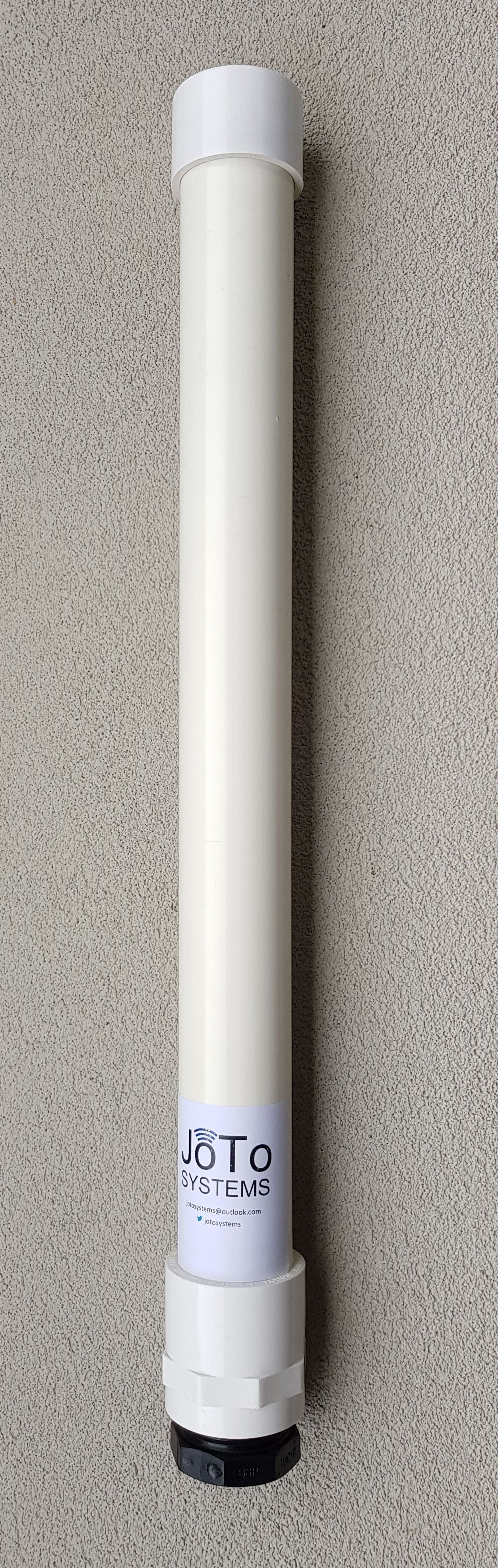

JoTo-1V
Self Contained, Water Proof, including inbuilt antenna
20191006_131831
Mounted on top of 7 metre steel tube.
Sean if you can wait a few weeks this is about to be released.
Fully self contained, water proof, rated for full sun at 45C ambient, PoE powered, extra I/O on the gateway and full reporting of Gateway performance.
