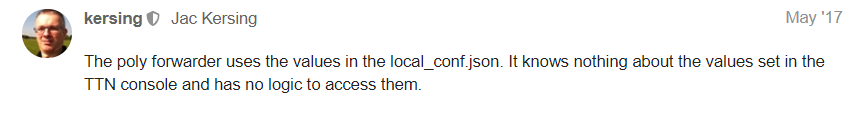

The poly forwarder uses the values in the local_conf.json. It knows nothing about the values set in the TTN console and has no logic to access them.
