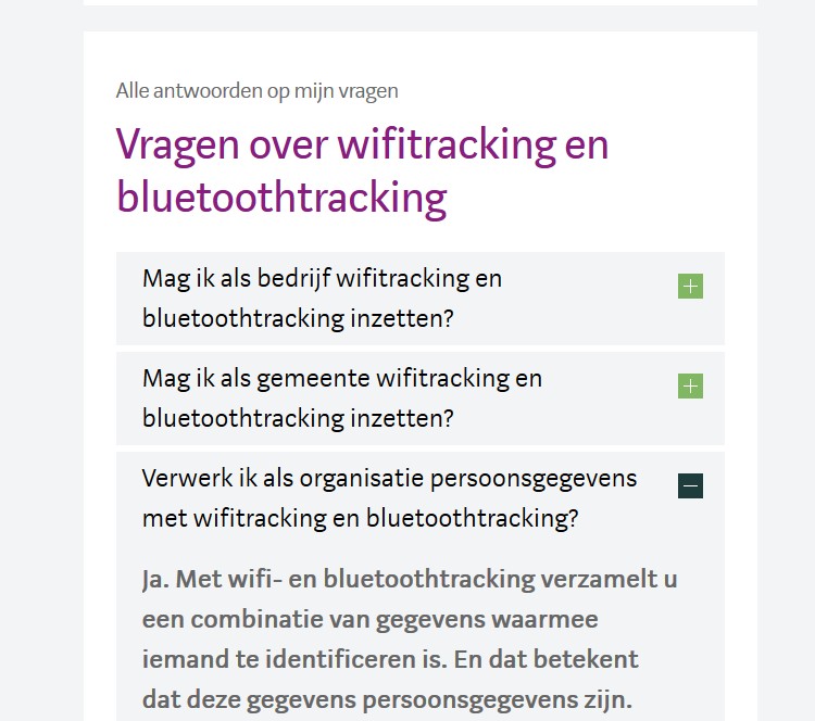

tracking (even hashed) not allowed in Netherlands ?
Sniffing does not necessary mean tracking.
Paxcounter software approach does only sniff and count, but not track (“volgen”).
Bad news for PAX counters using WiFi of BLE in the Netherlands (dutch article): https://www.destentor.nl/deventer/wifi-tellingen-in-binnensteden-deventer-apeldoorn-en-zutphen-stilgelegd~a55b7e64/
The article’s title mentions that ‘counting’ has been suspended in several cities. But inside the article mainly the term ‘wifi tracking’ is used, making it unclear if only tracking or also just the counting is prohibited.
That is so true. We have to wait for clarification on questions asked. I do expect answers because som other companies are affecetd by this too.
