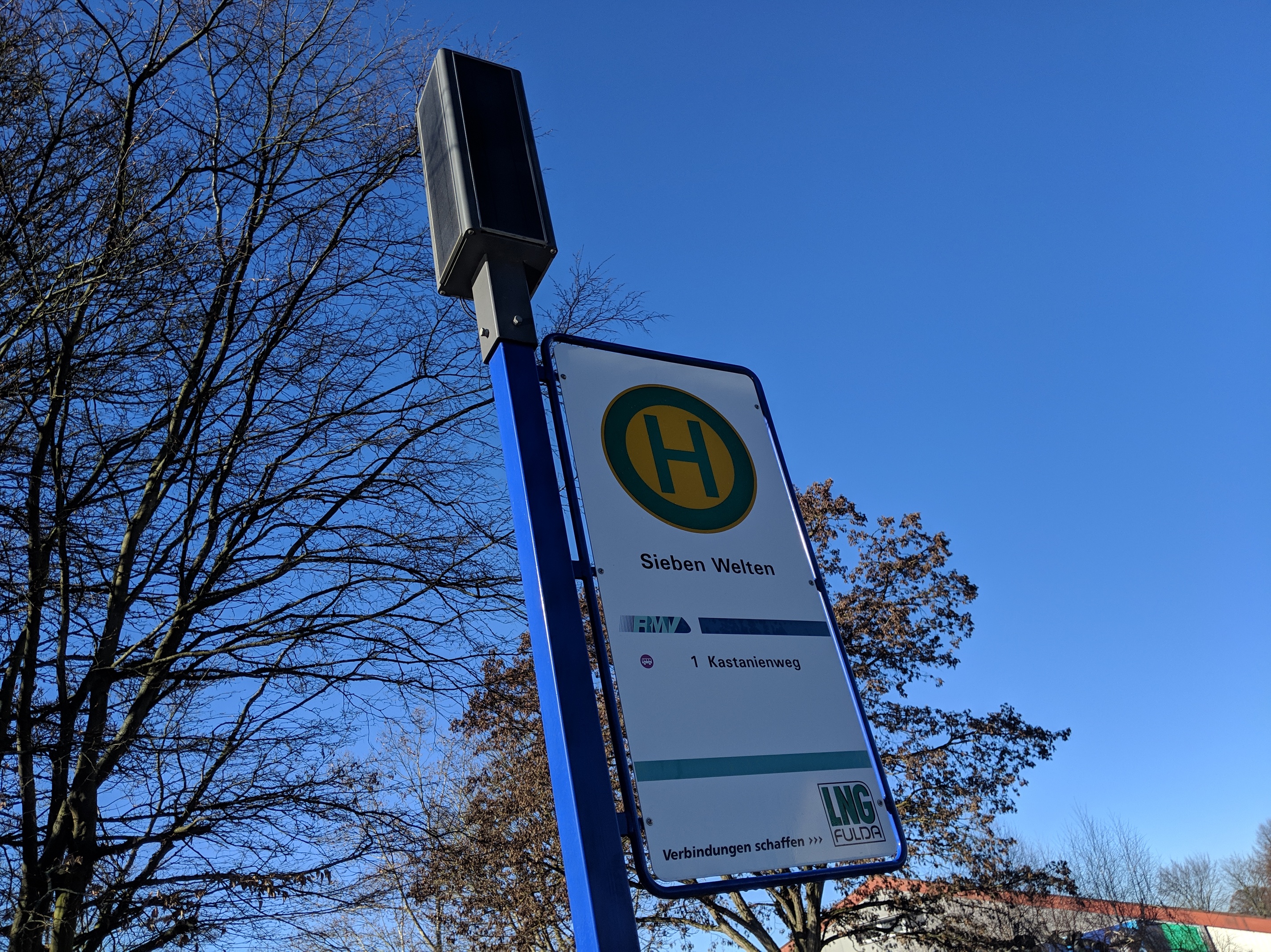

We need a paxcounter right here, inside of this solar box on top of the pole!
