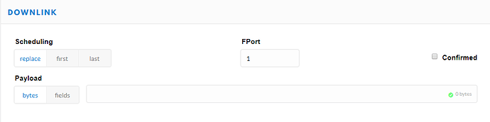

But how can I set the RSSI limit via downlink?
I guess I use the downlink form in the concole of my device.
I I read the README where it says:
0x01 set scan RSSI limit
1 ... 255 used for wifi and bluetooth scan radius (greater values increase scan radius, values 50...110 > make sense)
0 = RSSI limiter disabled [default]
Bat what does this mean.
What does the Payload look like?
Do I just send 0x0164 ( 0x01 ? for rssi and 64 for 100) if I want to set the rssi limit to 100 ?
Thanks
P.S.: I posted this question with the wrong account earlier.
That’s correct…
And set the FPort to the configured command port (which is by default 2 if my memory serves well)
For RSSI = 100 you enter 01 64 (for 0x01 0x64) in console downlink field, change FPort to 2, then press send.
Thanks.
It works. :slight_smile:
