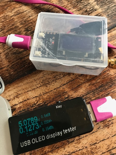

Nice project. Compliments on it! Tested the counter with my TTGO V1. Did a measurement on power consumption and get 646mw with display off on 5V;
